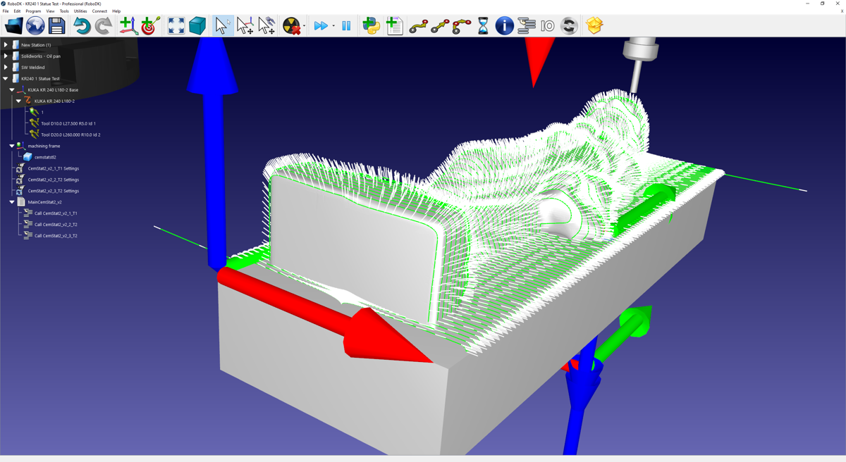

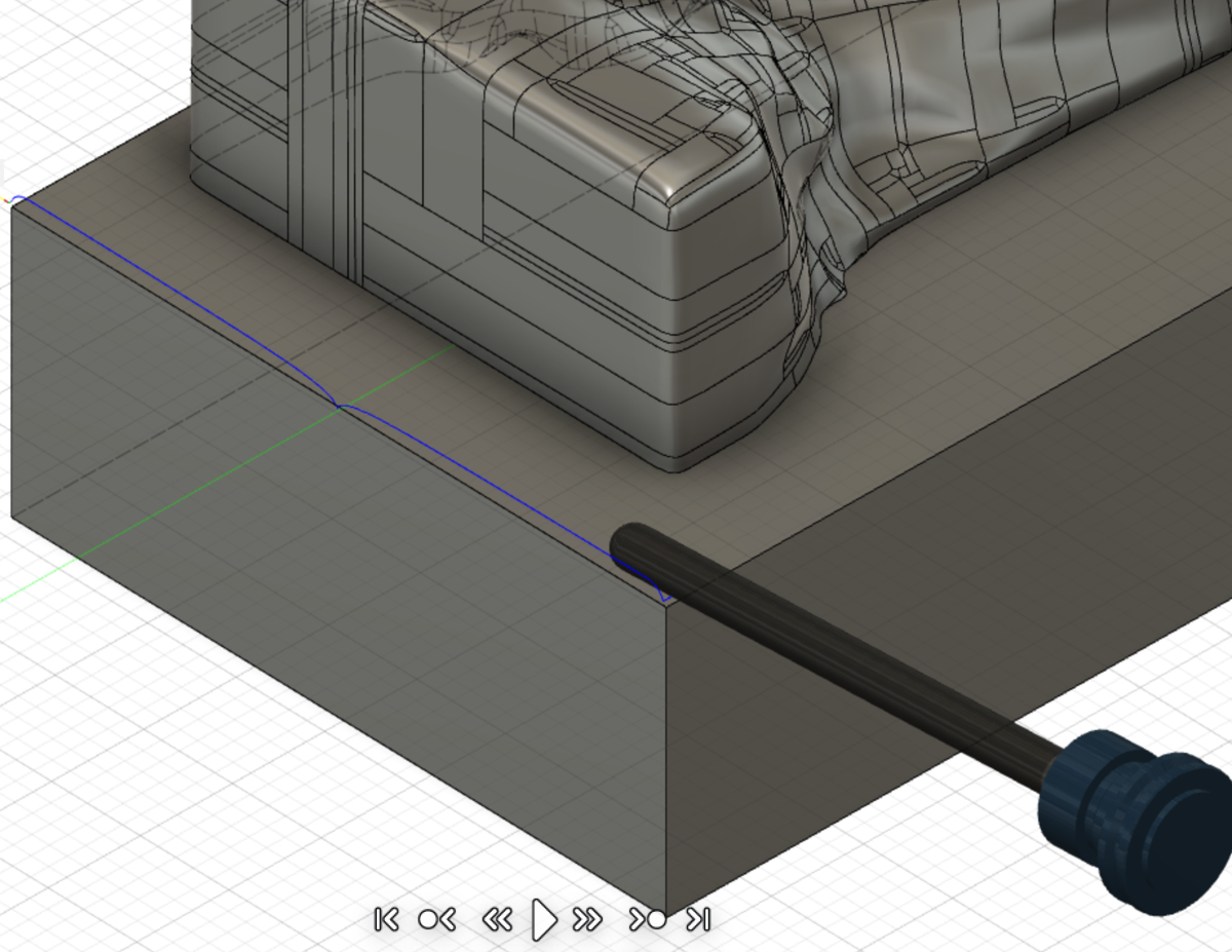

Hi, I am trying to create a 5 axis machining project. I am creating toolpaths on Fusion360, then loading the .nc file into my machining project on RoboDK. With 3 axis projects the normals are correctly oriented, however with 5 axis or tilt, the imported normals on the path seem to be all over the place.
I have tried to re-orient the TCP but this does not fix the problem as the path normals do not seem to be rotated in any particular direction.
Any help would be greatly appreciated!

Hi Sam,
This seems to be a non-supported type of .NC file.
There's a post-processor in Fusion that can output .apt files. I know that RoboDK supports this format coming out of Fusion very well as I tested it myself.
But you don't really need to do so, instead, I recommend you to use our Fusion 360 plugin.
It will import the CAM program from Fusion to RoboDK automatically.
Take a look at this link for more details (There are some tutorial videos included in the documentation) :
https://robodk.com/doc/en/Plugin-Fusion3...nFusion360
The result using the plugin:
