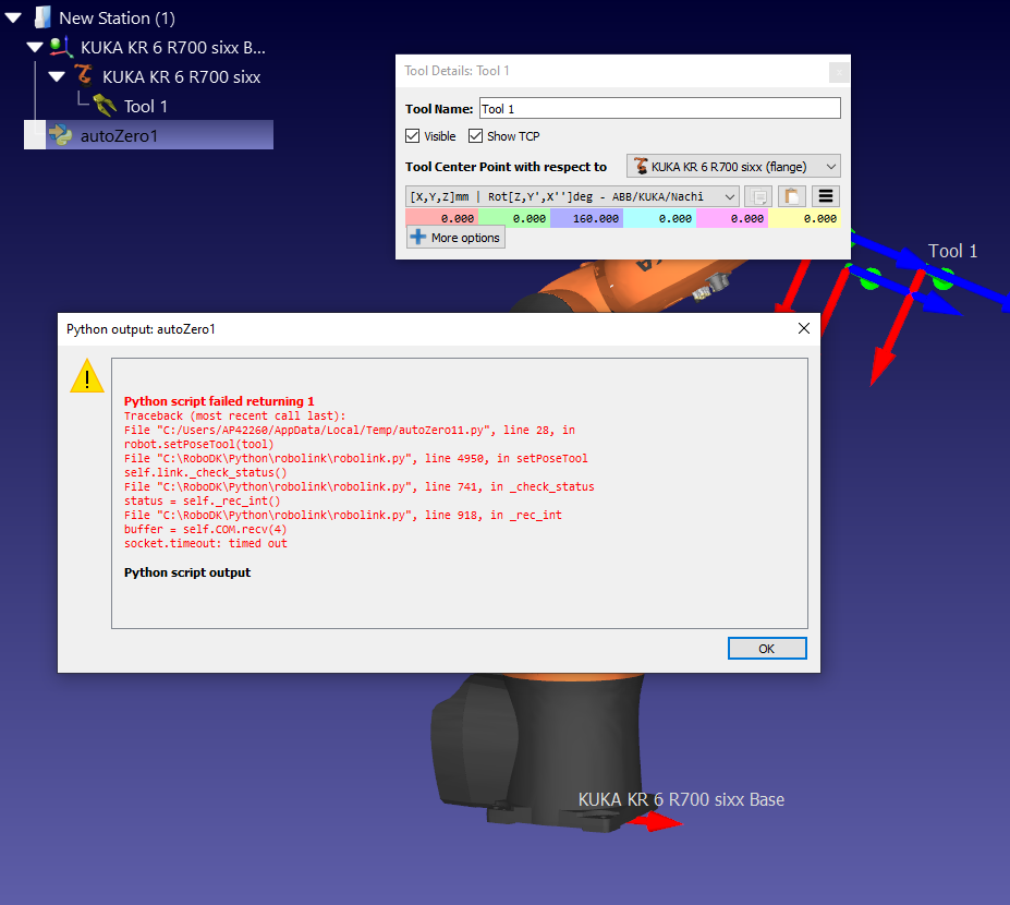

I'm trying to run Python program offline (code is attached). In roboDK, I added a Tool1 with defining his position, but I had a Python script failed as return (see screenshot). What is the problem ?
I tried to run it on robot too. I had a MoveL error

As the error code suggests you are reaching a time out of the robolink library.
I suggest you take a look at this thread:
https://robodk.com/forum/Thread-Timeout-...ht=timeout
