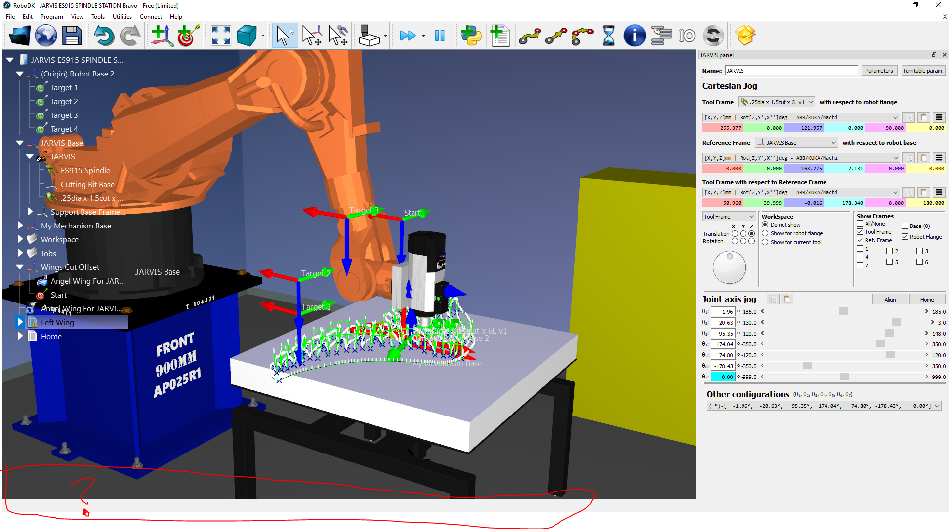

My play/pause/status/etc. bar that shows at the bottom when you run a program keeps disappearing. Tried restarting. Shut down the PC and rebooted. Reinstalled 64bit download of RoboDK. Nothin'. I cant bring it back. It's disappeared before, and come back, but now it seems to just stay gone.

In the photo, I am running a program, but the play bar is missing. It came back briefly in the normal .exe, before disappearing again. After loading from "C:\RoboDK\RoboDK-Start-Defaults.bat", there was no change. It is still missing.
Nothing I seem to do really triggers it. I cannot recreate the problem with any specific steps. Just, as I keep running ther program, sometimes it shows up for a few cycles, then disappears again.
And it does not matter if I change programs or run other programs. Doesn't matter if its an imported CAM file, an auto-set-up from Fusion360 via plugin, or a native program made from creating target points.

Running the program with Ctrl+R does not open the sequence bar, while double-clicking the program should.
I added the attachment again. Is it there now?
I did not even know ctrl+R ran the program. Lol. I have only ever double-clicked a program, or right clicked and clicked "run."
Sometimes I will see a message bar at the bottom even when the play bar is missing.
It still just randomly disappears. There seems to be no connection between any combination of settings or actions. It's just there for a while, until I notice it is not. Feels like I'm rolling the dice each time I run a simulation. Then at some point, it just disappears while in the same station and program. closing and restarting RoboDK does not seem to have an effect either.
