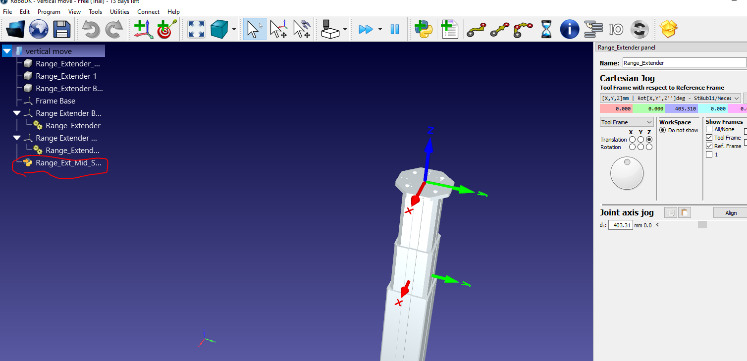

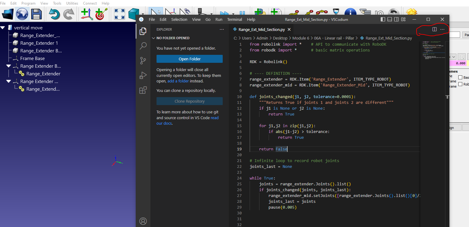

I have issue to run code by VSCodium. There is missing "Play" icon in my pc.
If I  insert Python program directly to the RDK program, all is OK. Pillar works synchronized.
I am cnofused why I could not start python code by VSCodium.
Please, is there someone who know this issue?

Go to the 4th icon on the left toolbar (Run and Debug) and click on Run and Debug. There should be a floating play/pause toolbar.
You can also use F5 on your keyboard.
