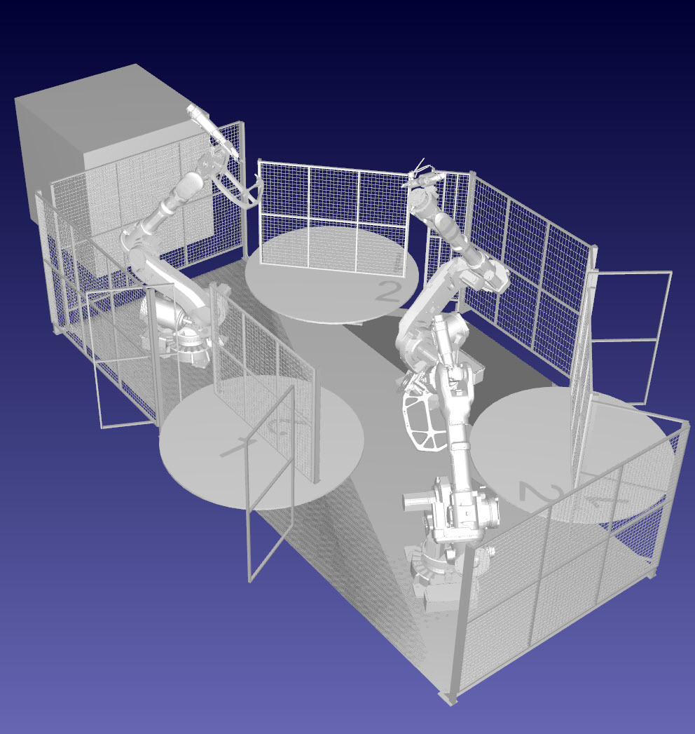

So, first issue; When I try to import Step files (please see attached picture 1) RDK freeze and try to consume all my memory liked cookies until it crashes.
I have tried to take my 3D models into Inventor firs, and use RDK's Inventor plugin.
The plugin can not handle .iam file apparently, witch making the plugin almost as useful as the DVD rewinder.
if i use Inventor and export to different file format i get different issues every time.
.iges only give me process points from the model (rivet nuts).
.stl only model, no color no process points, no anything.
I have also tried Spinnfire to convert to different format. no luck, only .stl seems to be good enough but still far from what I would like. (attached picture 3)

People generally don't bring station in one blow to RoboDK, you bring in the object separately or in a small group to be able to move them at will afterward. By importing it all at once you are kind of hand caughting yourself from the get-go. But if you want to go down that path, you can change the import settings to make it smaller to import.
"Tools"->"Options"->"CAD"->"Fast Import settings".
I don't really see why you want to import the 3D model of the robot in a robot simulation software. It just increases the size of the file for something you will delete as soon as it's imported. People will generally just leave the robot stand/pedestal and remove the robots before importing from the CAD software.
