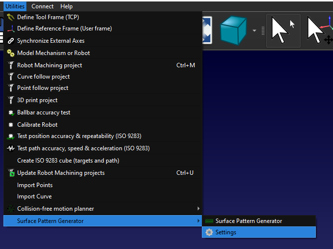

After installing the surface pattern generator add-in from https://robodk.com/addin/com.robodk.app....ngenerator, I am unable to use it.
When I attempt to open settings (screenshot attached), I get the exception shown below:
Python script failed.
Process: C:/RoboDK/Apps/SurfacePatternGenerator/Settings.py
Returned code: 1
File "C:\RoboDK\Apps\SurfacePatternGenerator\Settings.py", line 79, in
runmain()
File "C:\RoboDK\Apps\SurfacePatternGenerator\Settings.py", line 75, in runmain
S.ShowUI('Surface Pattern Generator Settings')
File "C:\RoboDK\Python311\robodk\roboapps.py", line 580, in ShowUI
self.__ShowUITkinter(windowtitle, embed, wparent, callback_frame)
File "C:\RoboDK\Python311\robodk\roboapps.py", line 765, in __ShowUITkinter
values_list = {key: getattr(self, key) for key in fields_list}
AttributeError: 'Settings' object has no attribute 'SECTION_PATTERN'
