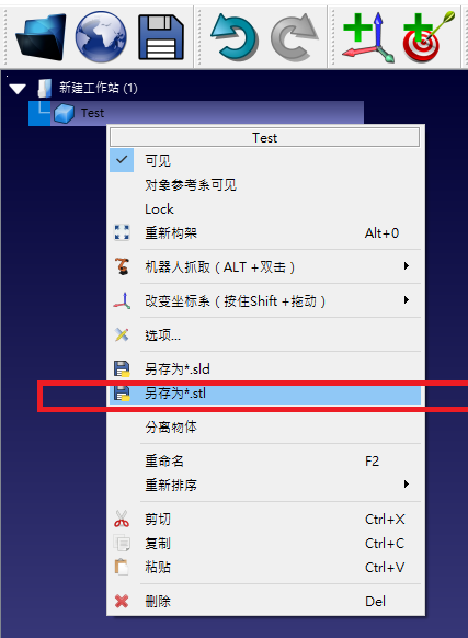

Hi Sit,
How to use the API to perform the Save Stl function,
As attached image(Test0001.png)
thanks
You can save your objects as STL files using the API by using the Save command:
object_item = RDK.Item("Object", Robolink.ITEM_TYPE_OBJECT)
RDK.Save("your-file-path.stl", object_item)
