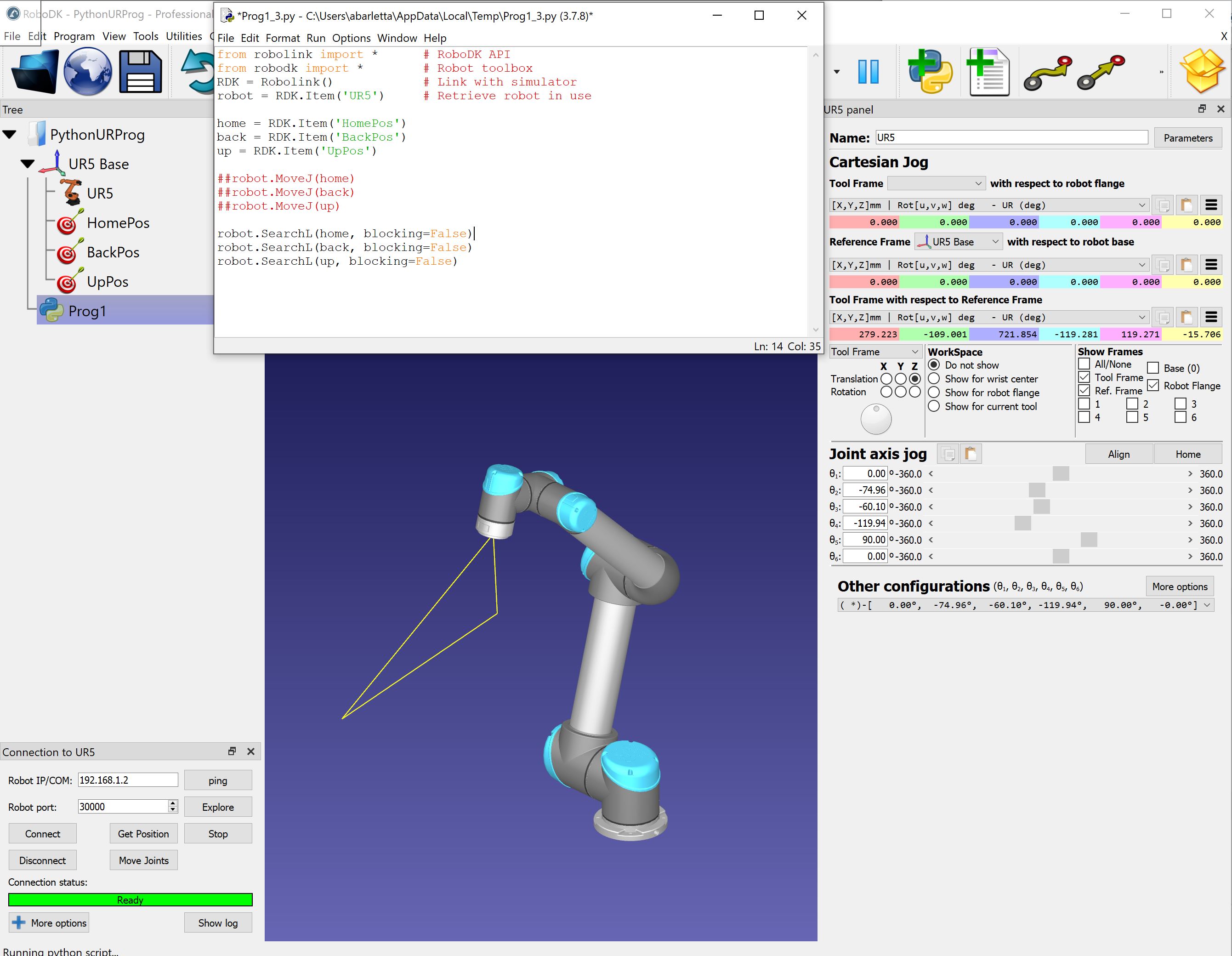

Hopefully my attached image is clear enough, but it is a fundamental example of what I would like to do. If I have a current motion that I would like to be able to interrupt via a Digital Input wired into the UR PLC. If my image can be referenced, the robot would move between 3 Targets continuously and if Digital Input 3 is triggered, I would like the robot to stop moving and proceed to whatever follows in the code.
It seems like SearchL() is perfect for this, but I was expecting there to be a third argument in which the Digital Input could be specified. Documentation shows, this is not how the function works and it only takes in two arguments: target and blocking.
