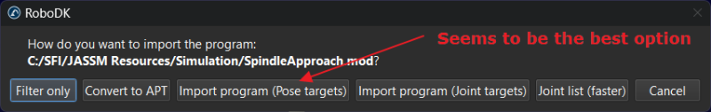

When I use the Python API to import the mod files, it pops up a couple dialog boxes that get in the way and require user input.  I need to suppress those dialog boxes and work around them somehow.  Here are the two dialogs:

It is currently not possible to suppress the popup when importing MOD files for your ABB robot but we'll add the option to suppress this via the API.

You should be able to suppress blocking popups when loading ABB RAPID MOD files (or any other robot programs) via the API with the next version shared publicly by using the Popups=0 command:
# Remove blocking popups:
RDK.Command("Popups", 0)
# Load the file using AddFile
RDK.AddFile("path to program file")
# Revert back
RDK.Command("Popups", 1)
You can preview it with this version here (not a public release yet):
https://drive.google.com/file/d/1rMNFOT5...sp=sharing
Let us know if it does not provide you with the expected results.
