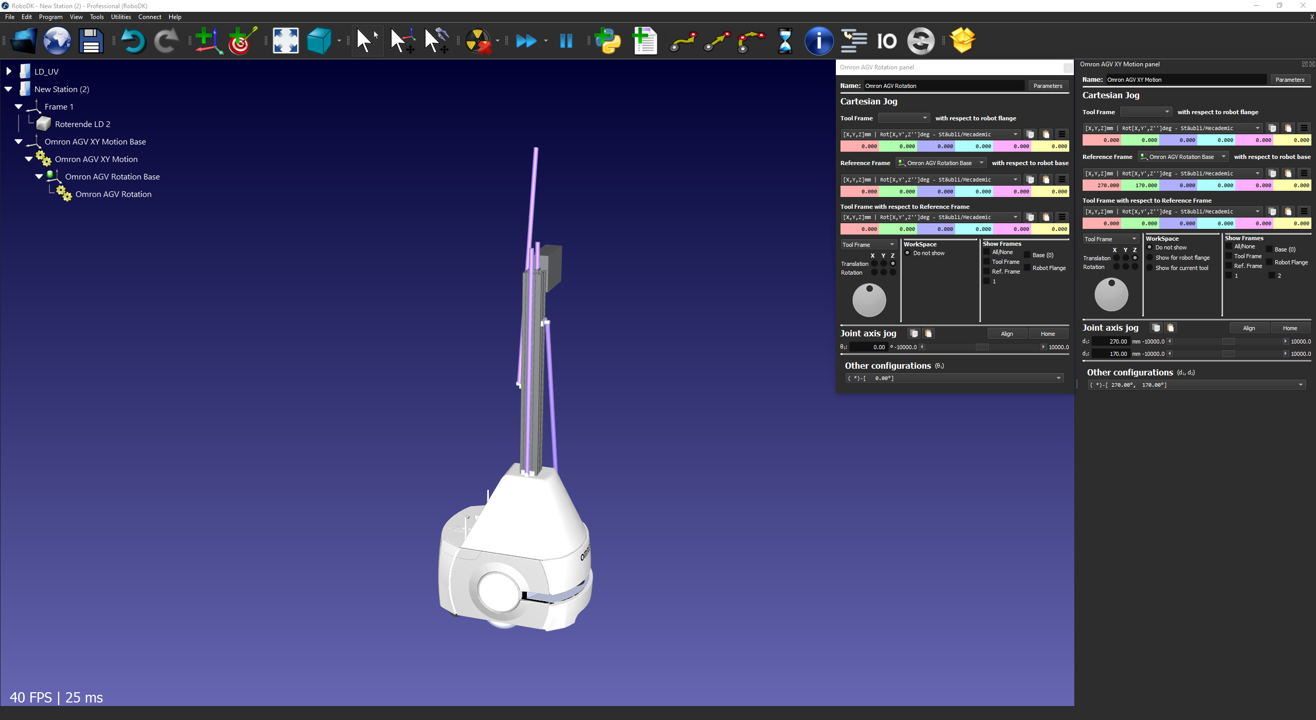

Hi AnderS,
We didn't do any AGV simulation, but I took a few minutes to build a better mechanism for you.
I stacked 2 mechanisms on top of each other. XY movement and Rotation.

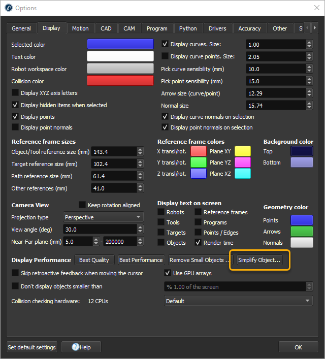

For the lag you experienced, I recommend you use the "Simplify Object" feature before creating such mechanisms.
