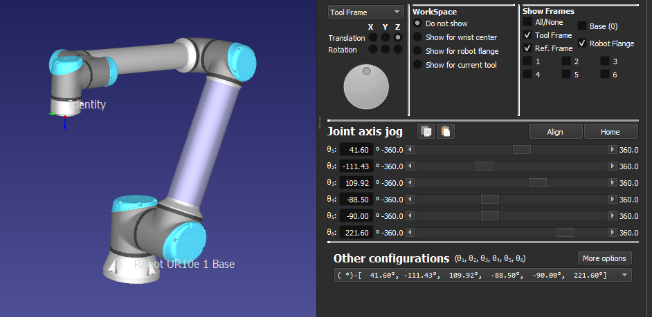

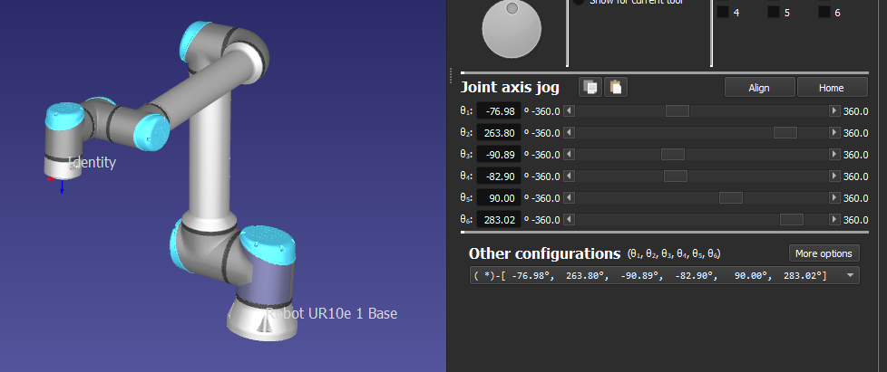

Why is it that when I sometimes use SolveIK even with a provided joint reference the robot will try to do weird joint movements just to get to position?
The positions I would want the robot to move to are in front of it with the 6th joint being the only one needing to rotate the whole -360 to 360 range.
Original joints
Joints after applying solveik

One way to obtain the joint values that are closer to the current location is to provide the current robot joints to the SolveIK function.
Example:
joints = robot.SolveIK(pose_base_to_flange, robot.Joints())
Another option is to use the SolveIK_All function to obtain all possible solutions and filter for your preferred option.
https://robodk.com/doc/en/PythonAPI/robo...em.SolveIK
