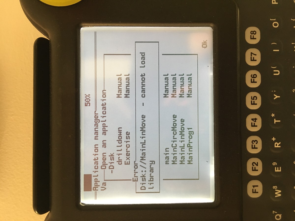

Hi Albert
It seems that using any of the Staubli Post Processors for programs including circular moves, except for the 'Simplified' version, gives an error of some description (see attached).  I've tried changing the min/max arc sizes as you suggest, but I still get errors. Do you have an example that you know works that I could try perhaps? It's an RX60L running on a CS8.
Many thanks, Jonathan

Hi Albert
I've tried using the updated post-processor, but I still get an error once transferred to the CS8 (see attached).
I've also attached the .rdk file that I've used. It's fairly complex so I'll try with something simpler too.

I've tried your two suggestions, along with the updated post-processor, which now gives a different error (see attached). The good news - it now works as expected using the 'VAL Simplified' post-processor which is great.
I'll keep trying different things, but as you might have guessed, I'm a beginner!  Thanks again.
You should make sure you transfer all the files of a program to the robot controller.
You can use the FTP transfer (Right click a program and select Send Program to Robot). Make sure to provide the correct IP of the robot and the remote path (path on the controller). I recommend you to use FileZilla to explore the controller files and locate the path where you want to place the programs.
