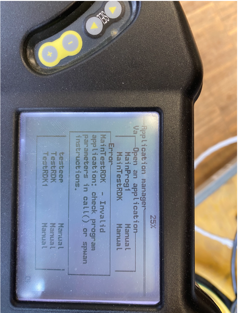

i also tried to use "Send program to robot", but then when i try to start the program from the interface on the pendant it gives the following error:
Invalid application: check program parameters in call()
or spwan instructions

Regarding the function "send program to robot" with all post processors (including the one attached to the link you sent me) the program is sent to the robot, but when I try to open it from the tech pendant always returns the same error as in the attached photo.
