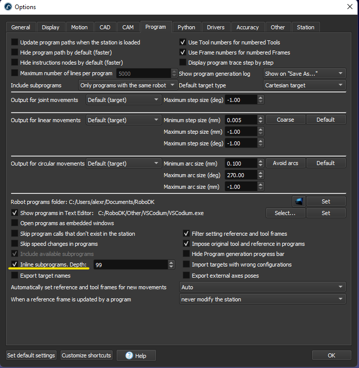

You can go to Tools -> Options  in the Programs tab there is an option for include available subprograms.
You can also activate inline programs.
I have this option checked already.. could it be something else?
First are you sure you should use the RJ3 post-processor for the CRX robot?
Doesn't it use a R-30i controller?
Can you provide your .rdk station?
