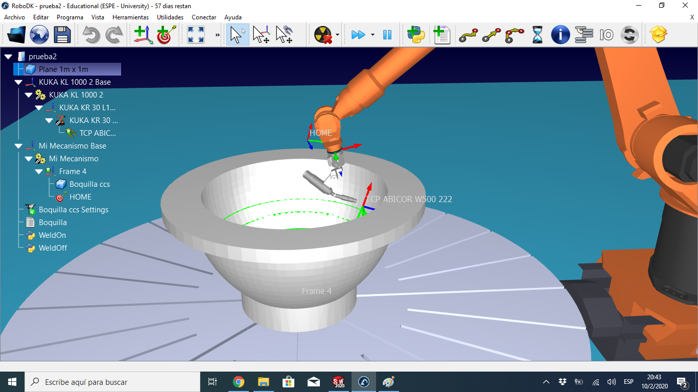

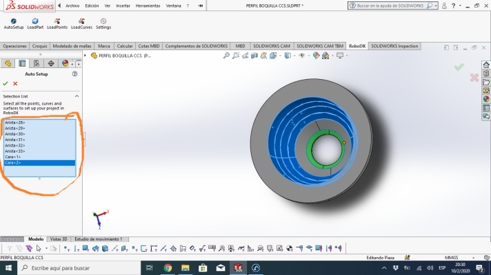

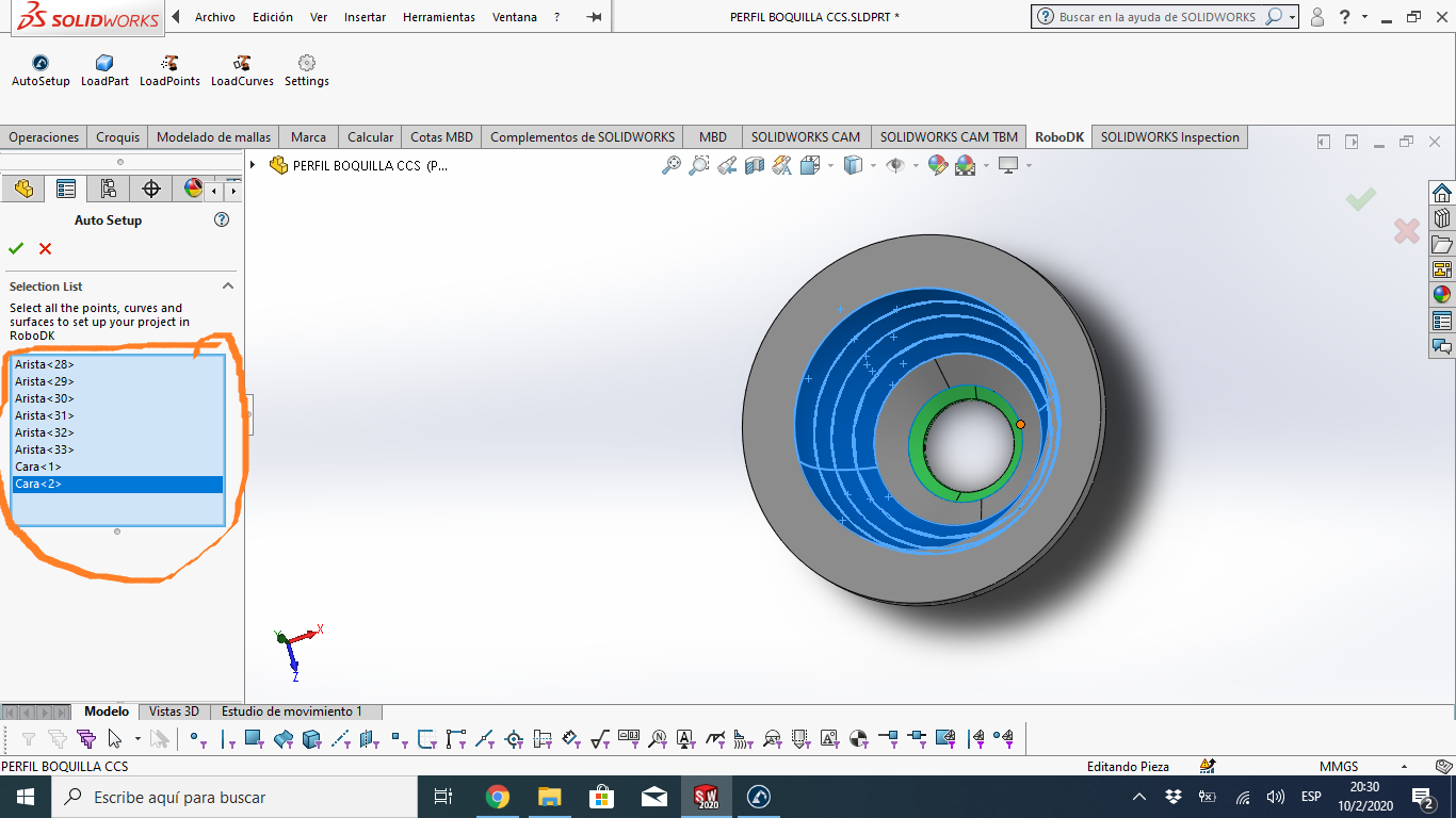

I have a couple of problems, when trying to generate more than two paths with the auto setup only take the first one, as I show in the screenshots

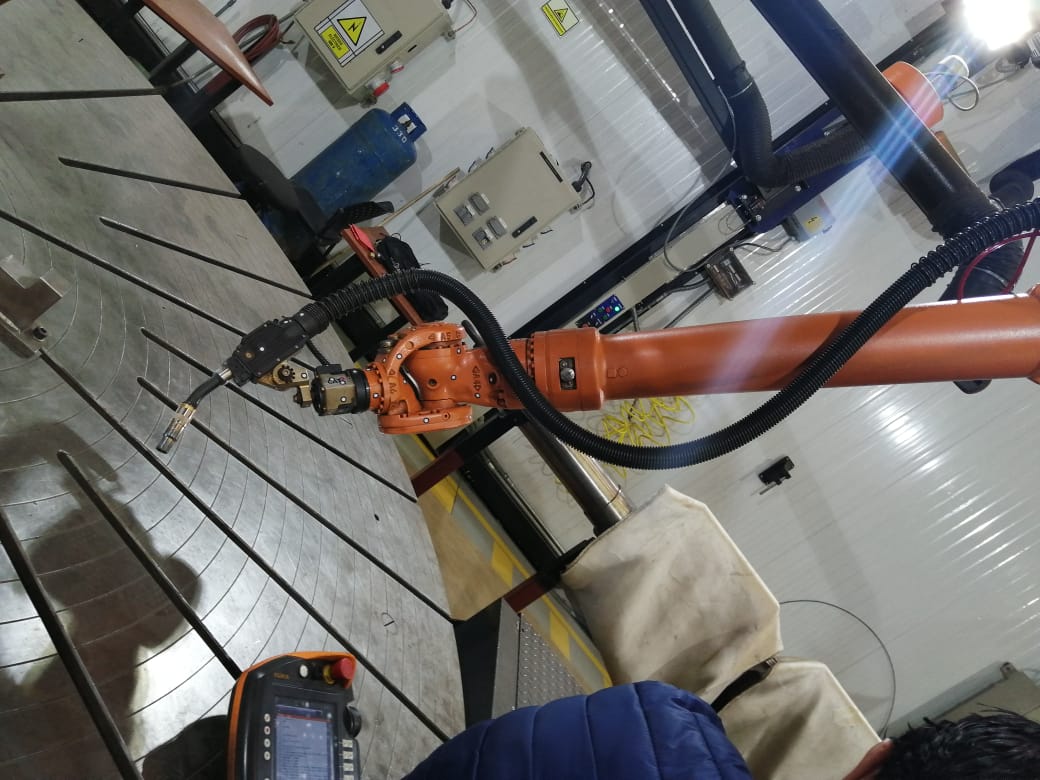

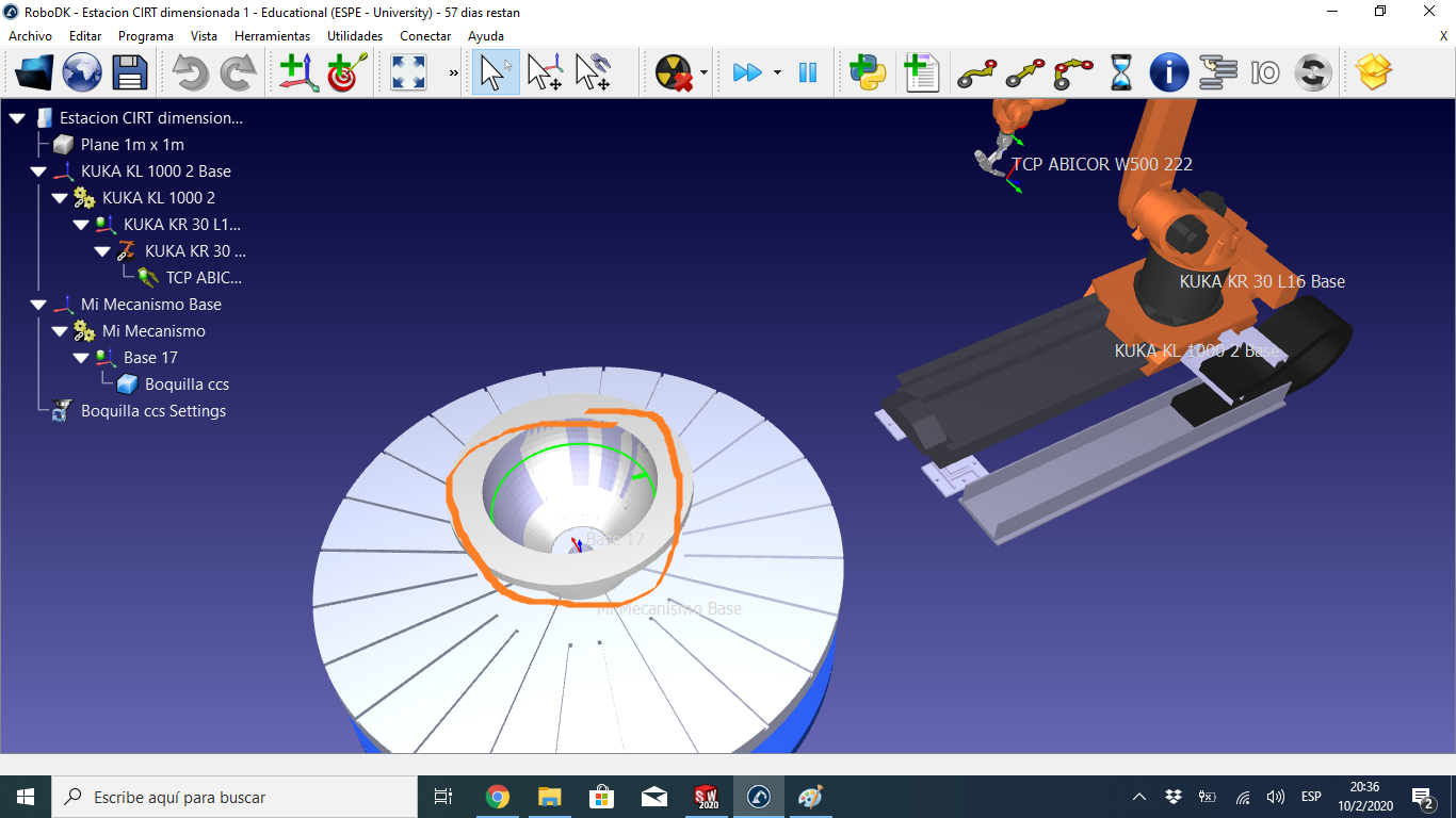

I made the modifications of the configurations that were suggested to me, but on occasion I acted in an unexpected way with unnecessary movements of the joints and stopping the turntable
How could you declare a rotational basis? the base and tool that are generated in the programming are not adequate and the physical robot moves differently to the simulation
