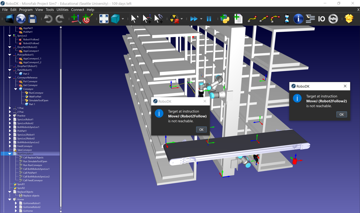

For some reason, all my programs work and shows the correct animation when I click one by one. But when I make a main program to make them all run with a click, errors like "MoveJ () is not reachable" pop up. The correct animation even happens in the background while the errors pop up. How come this happens?
I understand my image is bad, but this pops up while the animation plays, which looks correct.

You got a synchronization problem, that's why.
BothRobotsSyncLoc1 sub program only contains Threads, so the program pointer won't stop in this program call, it will jump to "Pick Part 1".
As the first instruction of "Pick Part 1" is a set frame, it makes the relative position of the next move in "SyncLocRobot1" still running out of reach.
You need to make sure the program pointer stays trapped in "BothRobotsSyncLoc1" until both "SyncLocRobot1" and "SyncLocRobot2" are done.
