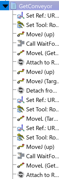

I did the program on Robodk with targets etc.
now i wanted to pass all these movements to a python program, how do i define the targets in python can help me
.png   alvos.PNG (Size: 34.54 KB / Downloads: 595)
You'll find a basic example here:
https://robodk.com/doc/en/PythonAPI/robo...AddProgram
And a more complete example here:
https://robodk.com/doc/en/PythonAPI/exam...to-program
