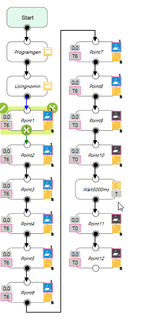

When I try to import my program on the robot (using a USB drive and following the steps from the RoboDK guide), I can import everything but when I try to run it, it gives the following error: Point type offline. See also image attachment 1.
In the project flow in TM Flow my point nodes are also grey encircled instead of green as they should be. See image attachment 2.
Why isn't it working?
