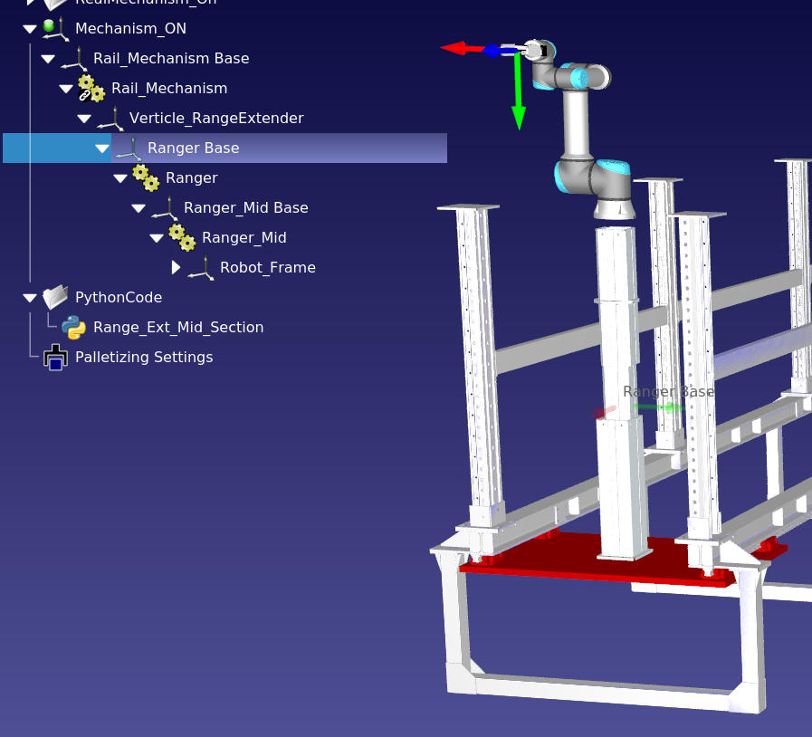

I recently went through this video as well. It looks like you did not have the right parent-child relationship set up correctly.
I made the Ranger_Base the parent of Ranger_Mid and made Ranger_Mid the parent of Robot_Frame. See the screenshot below.
You can check and set things like this over the API too.
In [7]: link = robolink.Robolink("127.0.0.1")
In [8]: item = link.Item("Robot_Frame")
In [9]: item.Parent().Name()
Out[9]: 'Ranger_Mid'
