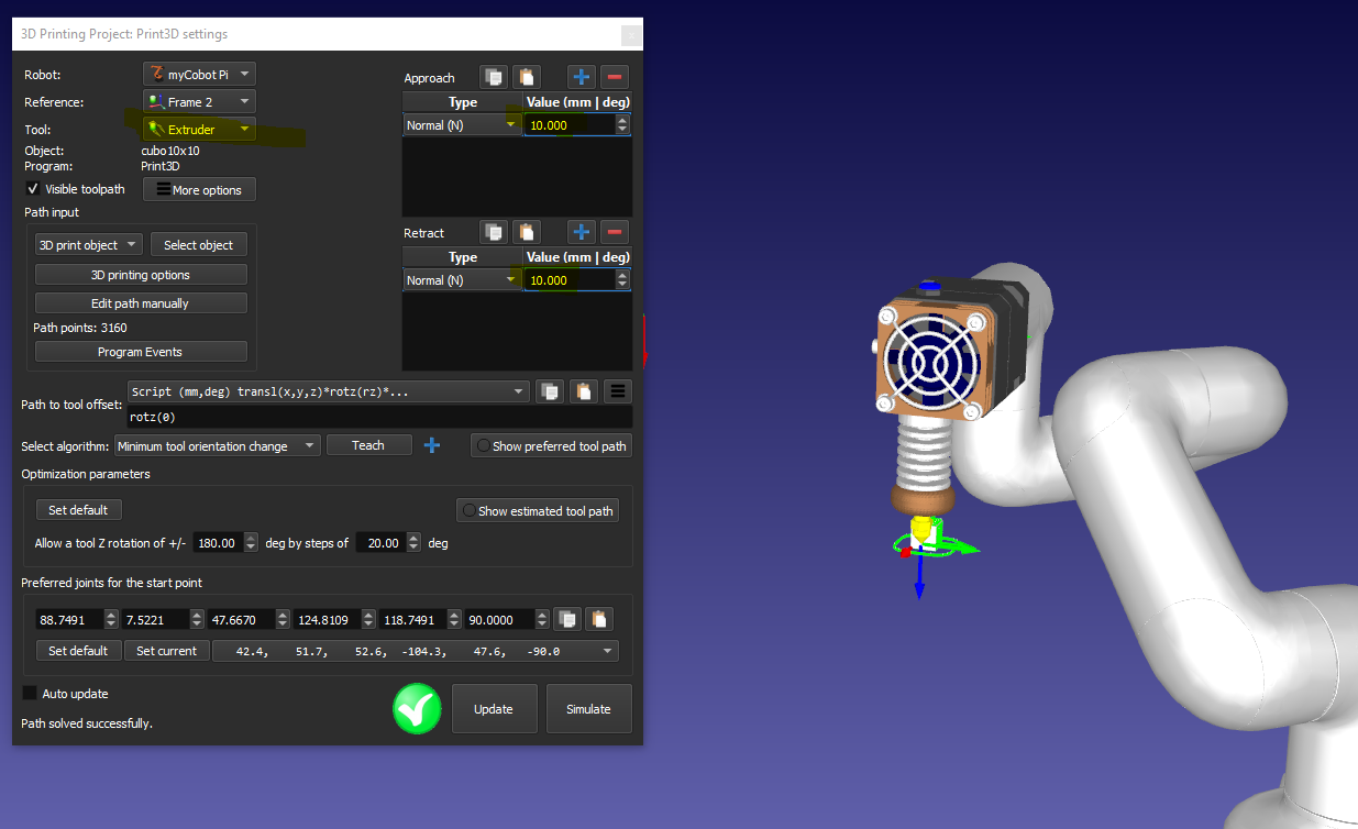

The curve follow project is using "Tool 1" as TCP, which is too far away from the path. Changing it to "Extruder" should fix the reach issue.
Also, reducing the Approach and Retract values help the robot to reach all the targets.
See the attached image.
