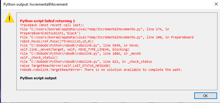

However, I am still getting some errors now and then. Is there a time in which i need to send a command to a robot for it to run correctly? I have connected to RTToolbox 3 simulator and I've tried to run a program on two robots. One is performing a set of moves and after that the other one is moving. If it takes too long for the first robot to move (over a minute) then the other prompts one of those two errors:
If i change the order in which the robots are moving, then everything works on the first and the second (which previosuly was first) is getting the same error as the other one before. So the robots move as long as there is short enough intermission between commands. I've managed to work around the problem, by making the robot that is waiting perform slight moves in between the first robot moves. Then those two errors don't appear.

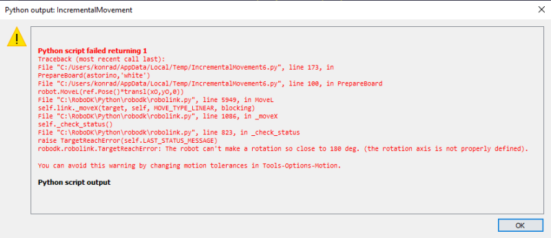

There is one more error that appears when the program is running on the robot. I think that it appears on moves that the robot had perform before, but I am not entirely certain. If that's the case it means that the move itself isn't an issue. This one stops the robot and the program:

#14
Thank you for your feedback. I understand you are now able to properly connect to the Mitsubishi controller using the driver without issues and you simply had to close the operation panel on the teach pendant.
Also, I understand the new issues you see from your code are valid error/warning messages from RoboDK saying you can't perform certain movements with your robot. For example, the rotation axis when you move 180 deg is not defined. You should instead break down the movement into 2 steps (2 rotations of 90 deg for example).
#15

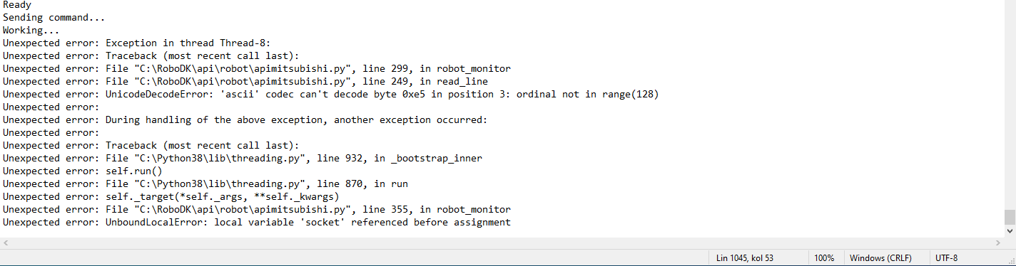

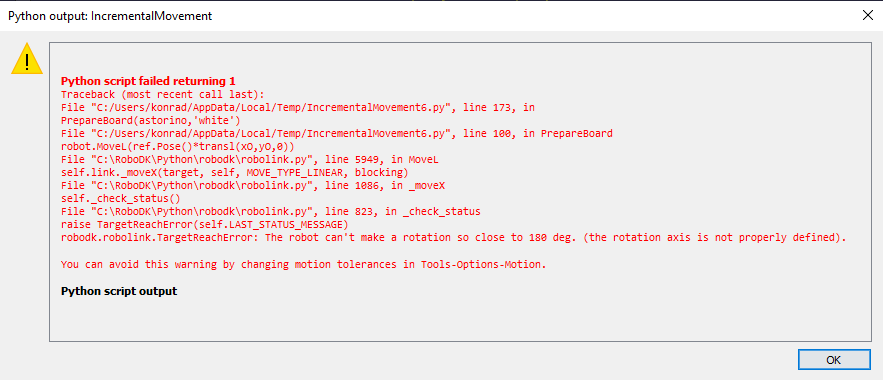

Like i said in the previous message, this error shows only if the robot has to wait before i send a move command. The robot always starts from the same position and is ordered to do the same list of moves. If the robot A moves first then there's no issues (except for occasional UnicodeDecodeError - please, tell me what's the possible cause of that and how can I fix it, if it's on my side and not the driver's), but if the robot B moves first and after that the robot A moves it shows and error like the one with rotation. It doesn't show it when the robot A moves first, it only shows if robot A moves second - has to wait before performing a move. That's what's confusing to me. The robot can perform the move if it doesn't have to wait, but if it does it saddenly says that there's no existing path or there's rotation error.
#16
Are you moving a robot to a target with respect to a coordinate system held by another robot? If so, the movement may be or may not be feasible depending on the moment you trigger the movement if the second robot is moving.
#17
I don't think so. I have three targets assigned to one robot and three to the other. The robots never move at the same time. If I make the robots make one move at a time, meaning first performs one then the second performs one move and so on let's say up to ten moves each, it works fine, but if I make them perform ten moves at a time, meaning first robot performs ten moves and only after that the second one is to perform ten moves, the second one will pompt an error, either rotation or path error. The sequence of moves is the same in both examples, nothing is changed. I can only assume that somehow the time is involved. But for me this error is not as essential as the UnicodeDecode one.
#18
We are updating RoboDK again this week to fix the Unicode issue you are bringing up.
#19
We just updated RoboDK to the latest version (Windows only).
Can you try the Mistubishi driver again with the new version?
#20
Everything seems to be working fine right now. Thank you very much for your help on every step of the way. I really appreciate it.
