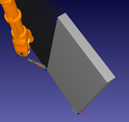

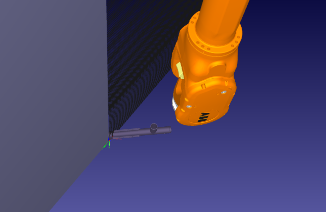

Hello Albert,
Thanks for your replay, i was trying 3d printing simulation like in my attachment, and the wall (what we want to print) was between existing wall, so we need different tools orientation at each side (left/ right) like in the picture, so the tools not collide with existing walls. i think this case was same when we use the g-code too not just the curve follow project.
i was try with minimum tool orientation change and tool orientation follows path too, but the orientation was not like what we need, iwas trying too with other solution like my last post, but it too hard because this 3d print project had so many layer.
i never use the custom API too, because I'm new with RoboDK. Hope you can help me with the solution. thanks
