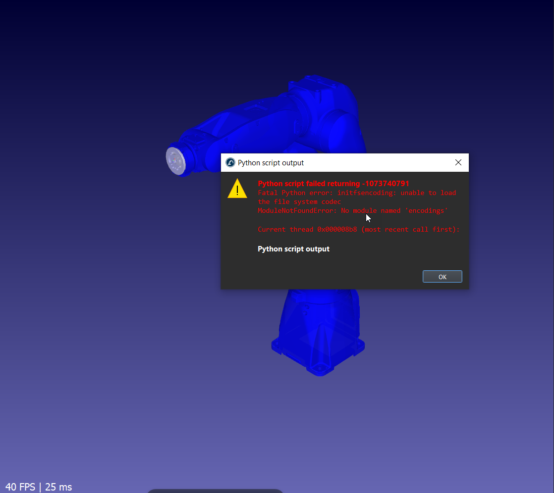

I am trying to upload the ALL.prm file from my Yaskawa GP8 (YRC1000) onto RoboDK to get the correct pulse/degree ratio. When I do this, however, I get this error:

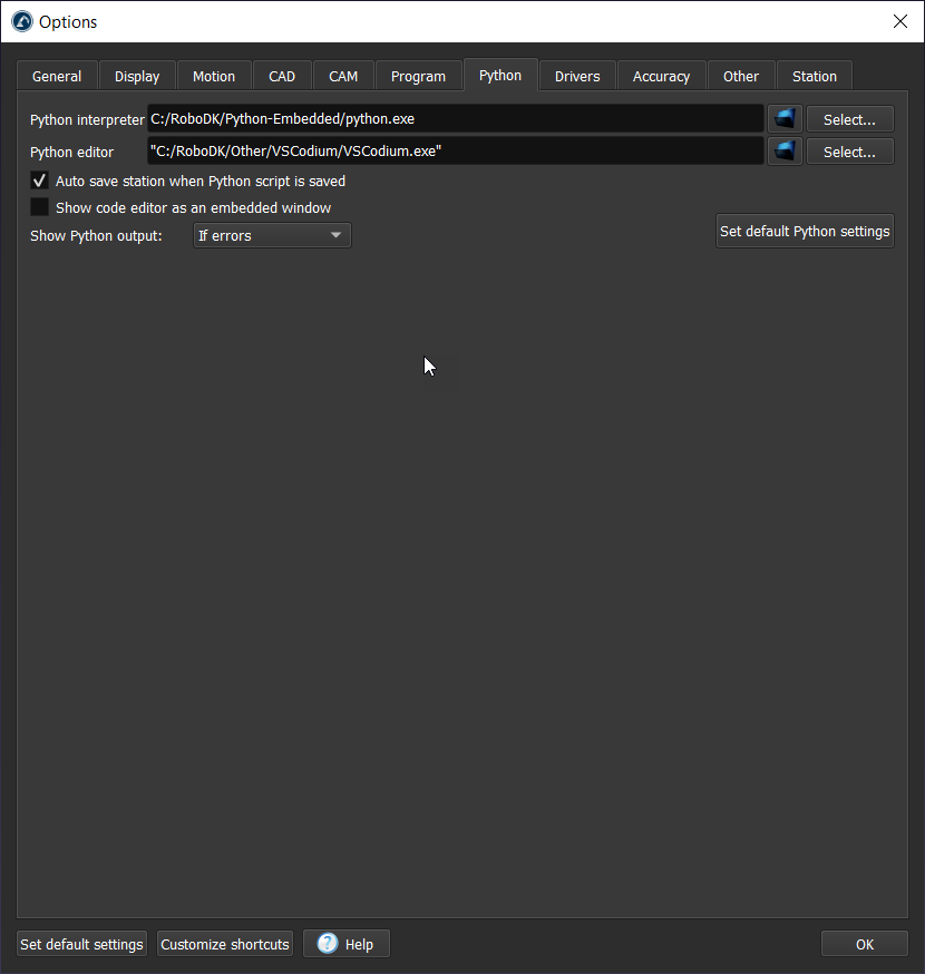

I adjusted the python options, according to another post, like this:
python options.png    .

Can you confirm if you are seeing this Python encodings error using the latest version of RoboDK?
(05-24-2024, 06:32 PM)Albert Wrote: Can you confirm if you are seeing this Python encodings error using the latest version of RoboDK?
Yup, I have version 5.7.3 installed.

I was unable to reproduce this issue importing the ALL.PRM file. Let us know if you have any other information you can give us to reproduce this issue.
