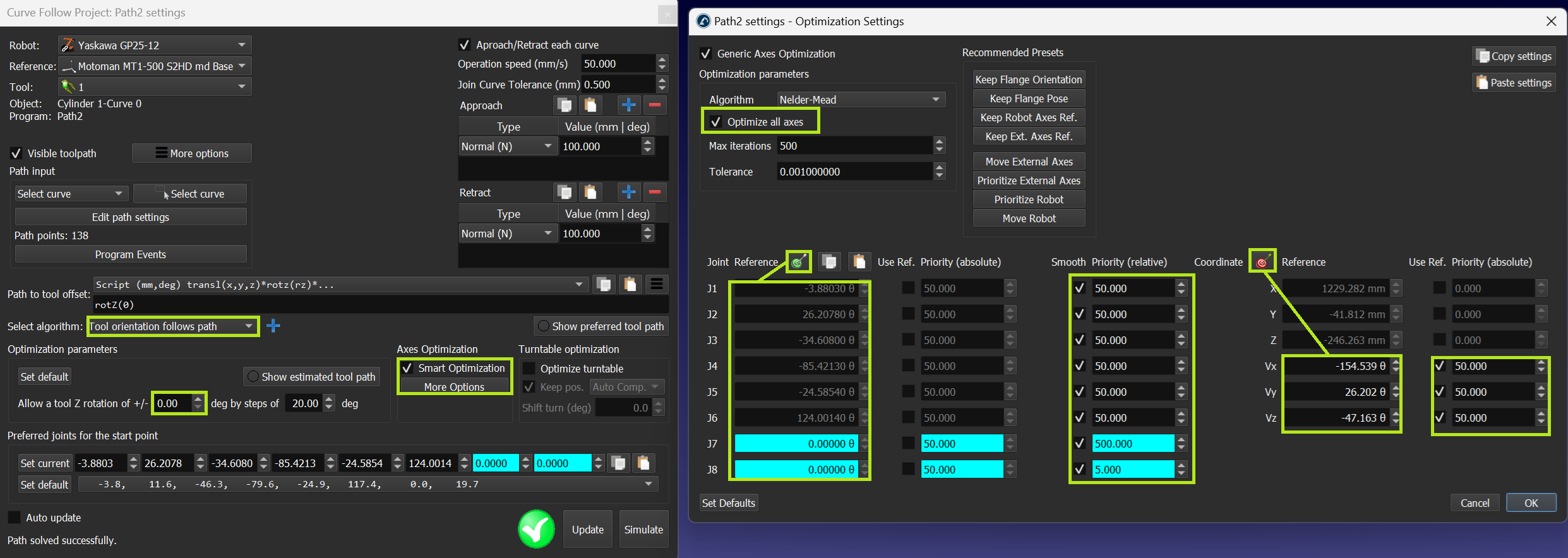

I attached an example of optimizing a simple circular path (using curves) with the robot holding the torch stationary and the positioner rotating.
Here are the optimization settings I used for this:

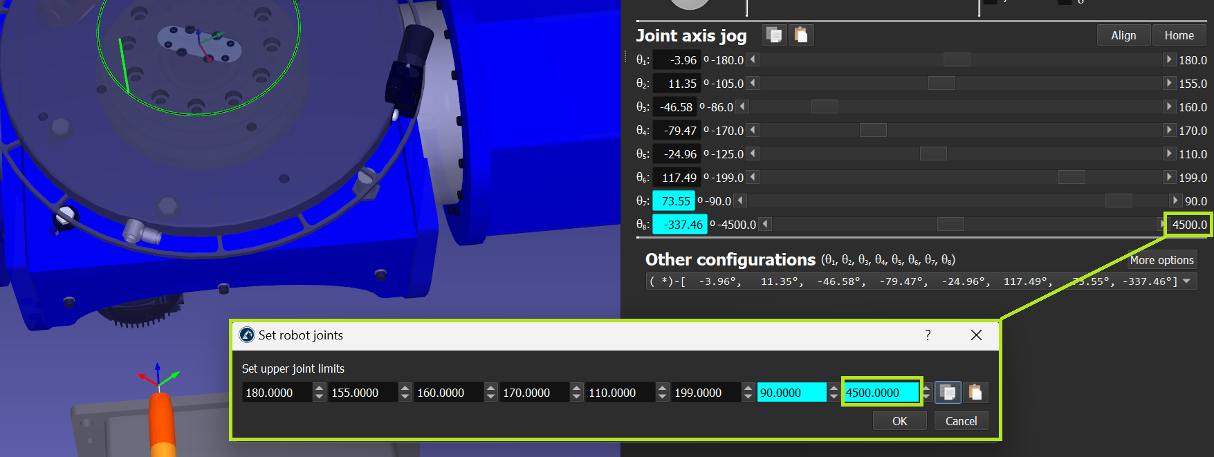

MY positioner will NOT go past 450 degrees (or thousands of pulses) and I have not discovered a way in robodk to rewind the positioner past this limit. It will just fail on updating toolpath.

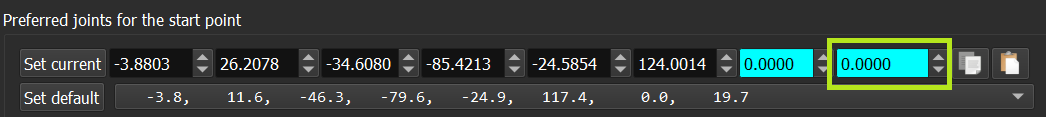

You can try splitting the original g-code and using parts of it with multiple machining projects.
You can then set the initial position of the rotary table for each machining project:
Alternatively, you can try setting the positioner endless rotation option and change the corresponding limits in RoboDK:
