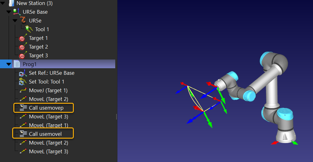

You can add a program call named "usemovep" to switch from the default MoveL to the MoveP.
You can add a program call named "usemovel" to switch back to the default behavior.
See picture:

Unfortunately this doesn‘t help. The Robot still executes a movel command After selecting „run on Robot“ and „run“. To clarify i just insert a „Programm Call“ with the Name „usemovep“,Right?
I also did read in a other post to change the „MOVEL_WITH_MOVEP“ in the apiur.exe.ini to true. This doesn‘t helped either.

This does not work if you are using the driver ("Run on robot"). That's for post-processed code. (When you actually generate URP or Script file).
There's a program automatically running on the controller when the driver is active, some kind of "listening" program, maybe you can look to change it in a way that is used MoveP instead of MoveL. I can't remember if you can access the program from the UR teach pendant or if this is locked under our compiled driver.
Just keep in mind that you won't have a fluid motion between points using the driver, as they's a handshake between RDK and the controller at the end of each motion.
