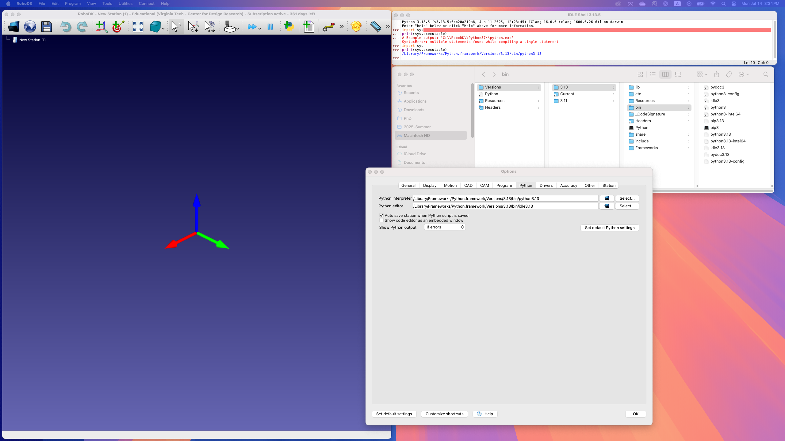

Make sure to add Python to your path. The Tkinter module should be installed by default. You can configure the Python interpreter here:
  1. Select Tools-Options (or RoboDK-Preferences on some versions of RoboDK for Mac)
  2. Select the Python tab
  3. Enter the path to the Python interpreter
#25

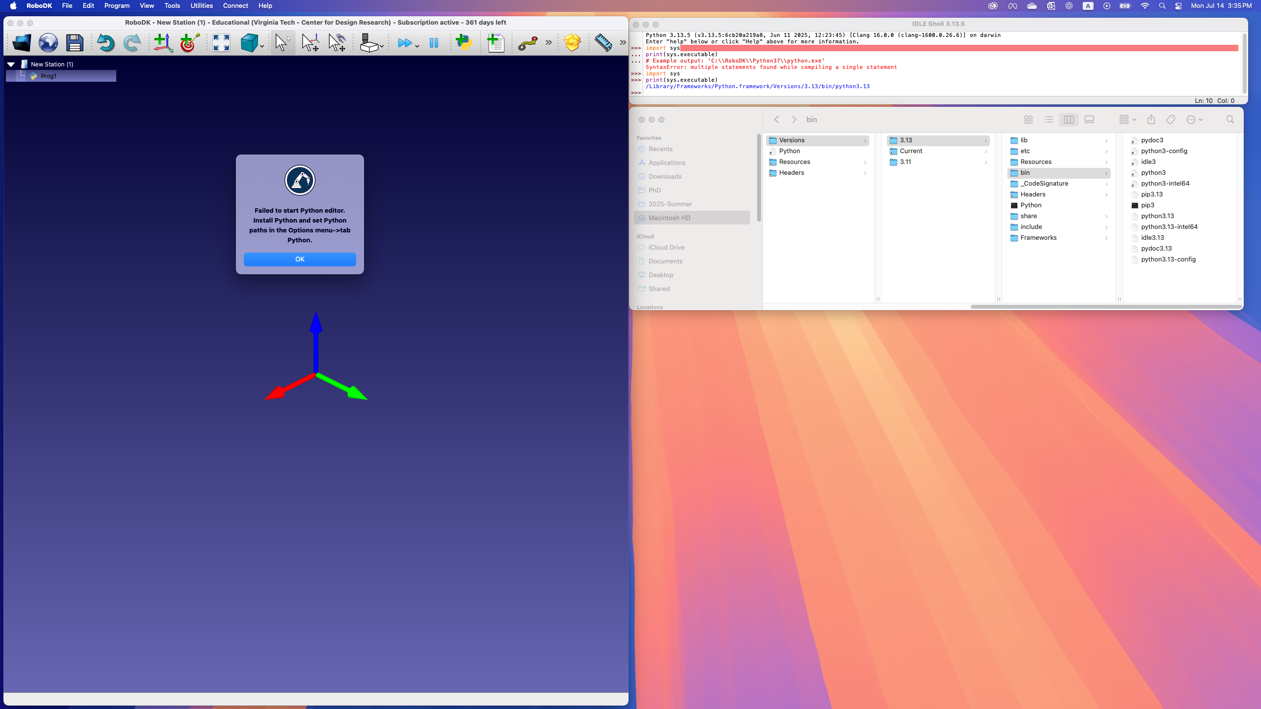

I tried using the latest version of Python, but I’m still getting the same error. I’ve attached some screenshots to show the steps I took, including the address and file location setup. Could you please take a look and let me know if I missed anything?

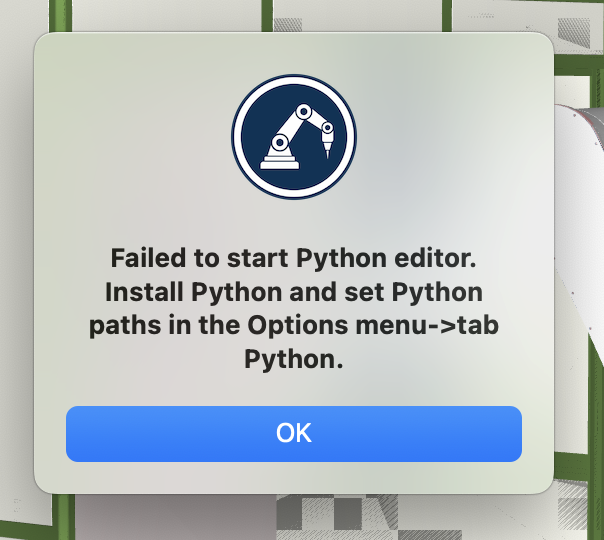

When I double-click the script, I see the following message in the bottom bar:
“Failed to run Python script. Install Python and set the path to the Python interpreter in the Options menu → Python tab.”
Even after entering the command you mentioned, I still can’t open the editor. I receive the same error in a pop-up window:
“Failed to start Python editor. Install Python and set Python paths in the Options menu → tab Python.”
My assumption is that the software is not recognizing or connecting to Python properly.

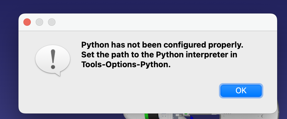

I am using maybe 5+ programs using Python scripts on my system. Fusion360, Blender etc.
Even RoboDK's Run Script command under "Tools" works without problems. I can run scripts like "Add Object to Robot, "Import CSV" etc.  However, when I try to use macros or scripts like SprayOn from the tree ("Edit" or "Run") or try to "Generate Robot Program", I get the errors in the attached screenshot snippets.
