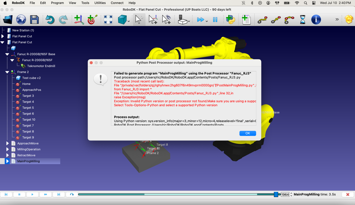

The error code:
Failed to generate program "MainProgMilling" using the Post Processor "Fanuc_RJ3"
Post processor path:/Users/ric/RoboDK/RoboDK.app/Contents/Posts/Fanuc_RJ3.py
Process output:
Using Python version: sys.version_info(major=3, minor=12, micro=4, releaselevel='final', serial=0)
RoboDK Post Processor: /Users/ric/RoboDK/RoboDK.app/Contents/Posts
Invalid Python version or post processor not found. Make sure you are using a supported Python version: /Users/ric/RoboDK/RoboDK.app/Contents/Posts/v312
Select Tools-Options-Python and select a supported Python version
Python Post Processor process exit code: 0

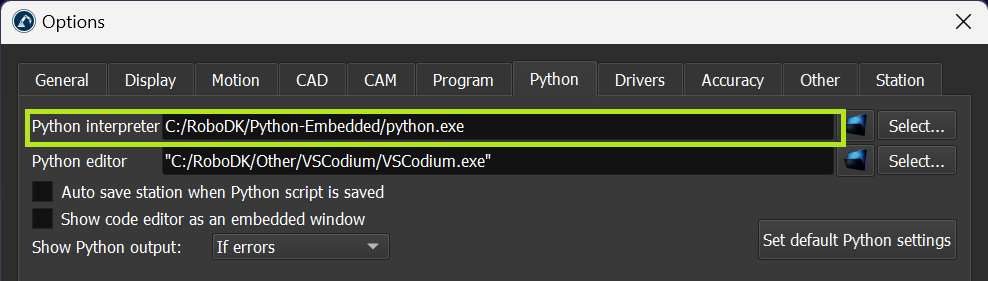

Please, select the Python-Embedded interpreter in RoboDK  (Tools - Options - Python - Python interpreter):
(07-11-2024, 09:56 AM)Sergei Wrote: Please, select the Python-Embedded interpreter in RoboDK  (Tools - Options - Python - Python interpreter):

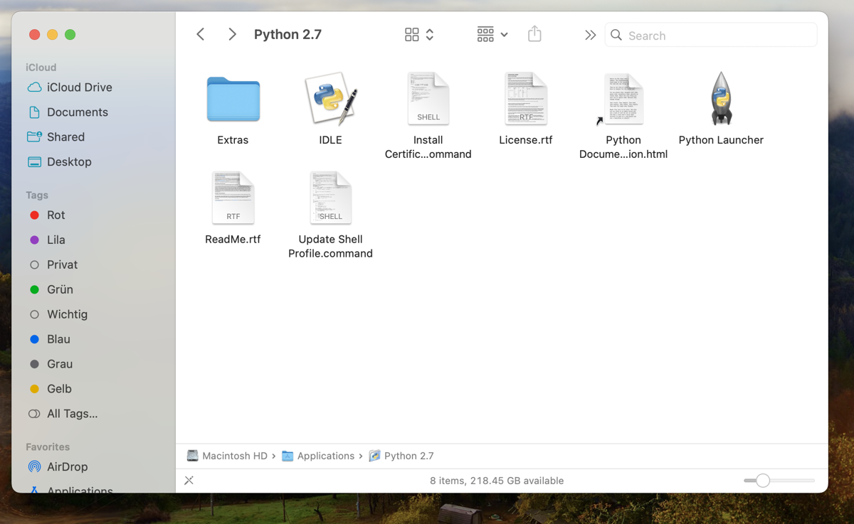

I have Installed the latest python version and there is a program icon named 'Python Launcher'.
However if I try to click on the Folder Icon on the right side of the path DIR nothing happens. I assume that that should open a finder window to point RoboDK to the Python install location, but nothing opens.

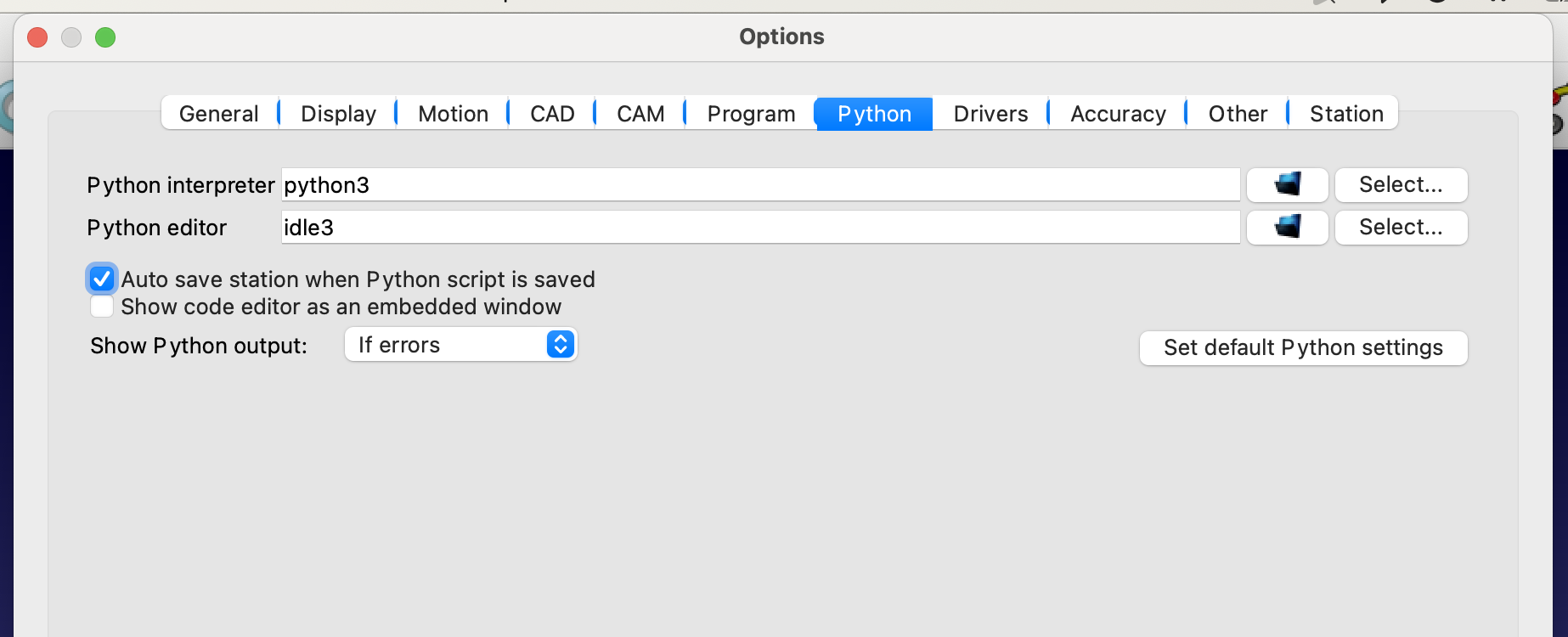

I've installed Python 3.11 and 2. and manually copied the direction into both fields, now I'm getting the following error with either version:
The Settings look like this: (attached screenshot)

Hmm, but that is not where Python is installed on my system.
Attached a screenshot of the folder that the Installer created.
Thank you for your help.
Attached the test file I'm working with, however I get the same error with anything I try to export as robo code.
The error message changed for some reason, I assume it has to do with choosing another version of Python.
Screenshot 2024-07-12 at 10.17.51 AM.png    Screenshot 2024-07-12 at 10.38.11 AM.png

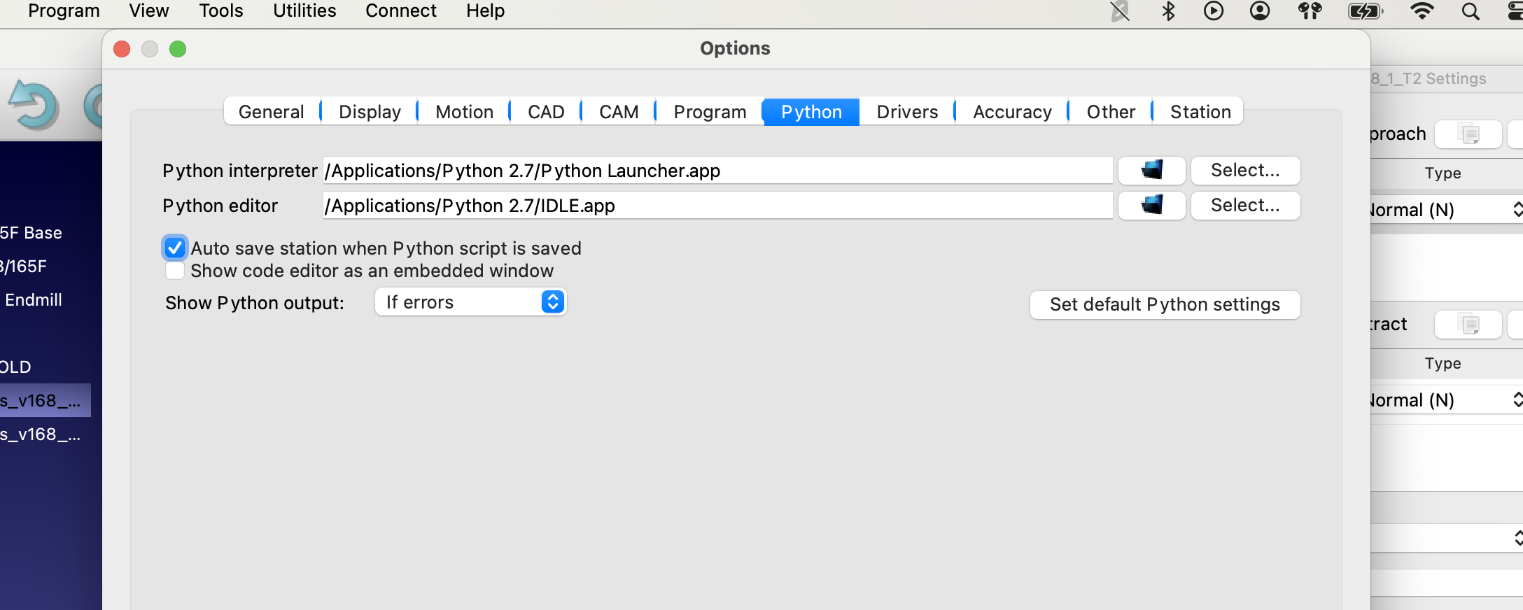

RESLOVED the issue by re installing RoboDK and entering the path settings as in the attached screenshot.
Great, thank you for letting us know!
