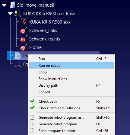

directly after setRunMode() and it seems to be fine. What seems odd to me is that, when I check the settings directly in RoboDK (see attachment RoboDK_01), the option 'Run on robot' is not active.
The other way round, if I activate 'Run on robot' (see attachment RoboDK_02) manually in RoboDK and then use a script to start the program, it is excecuted on the real robot as it is supposed to.
I am not sure what is wrong. Is RunMode=6 not equivalent to 'Run on robot' and I am therefore using it the wrong way or is it maybe a bug?

RDK.RunMode()The other way round, if I activate 'Run on robot' (see attachment RoboDK_02) manually in RoboDK and then use a script to start the program, it is excecuted on the real robot as it is supposed to.
