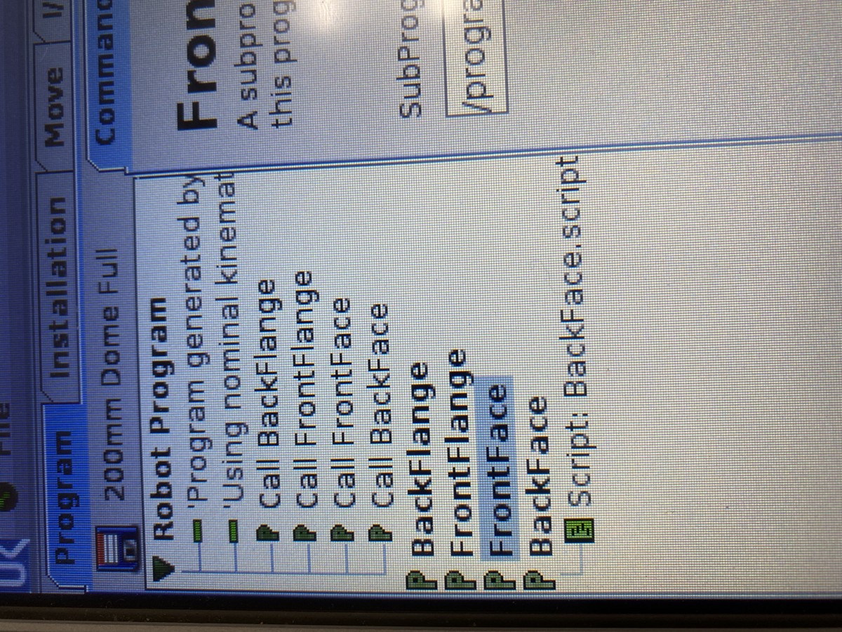

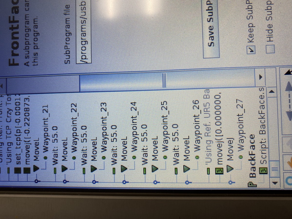

Jsmesny and I are working on the same project. Currently we're using a CB3 UR5 and the Universal Robots URP Post-Processor in RoboDK. Attached are screenshots of the main error we're having in Polyscope. We processed all the subprograms the exact same way, but some subprograms will say they loaded as URP files, but contain no editable instructions, and require us to manually input the script file (which we then can't adjust like the others) to run the main.
In the photos, the "BackFace" subprogram is the troublesome one. You can see above it, the subprogram "FrontFace" was loaded in correctly (subprogram instructions are hidden for one photo, and shown in the other).
We're using a flash drive to transfer the files over. We load the main program's URP file, then clear the call subprogram commands of their default file paths, and choose the correct subprogram (which is in the same folder as the main). For most, the URP file is loaded correctly. However for the BackFace, it pulls the correct file location, but no data, so we have to manually input the script code into a new "Script Code" function within the subprogram.
We do the same process for all 4 subprograms, yet only one is causing issues. We've been experiencing this on multiple stations, and it's the same subprogram within each station each time, for no obvious (to us) reason- as there's nothing unique about those subprograms compared to the others, as far as functions go.
