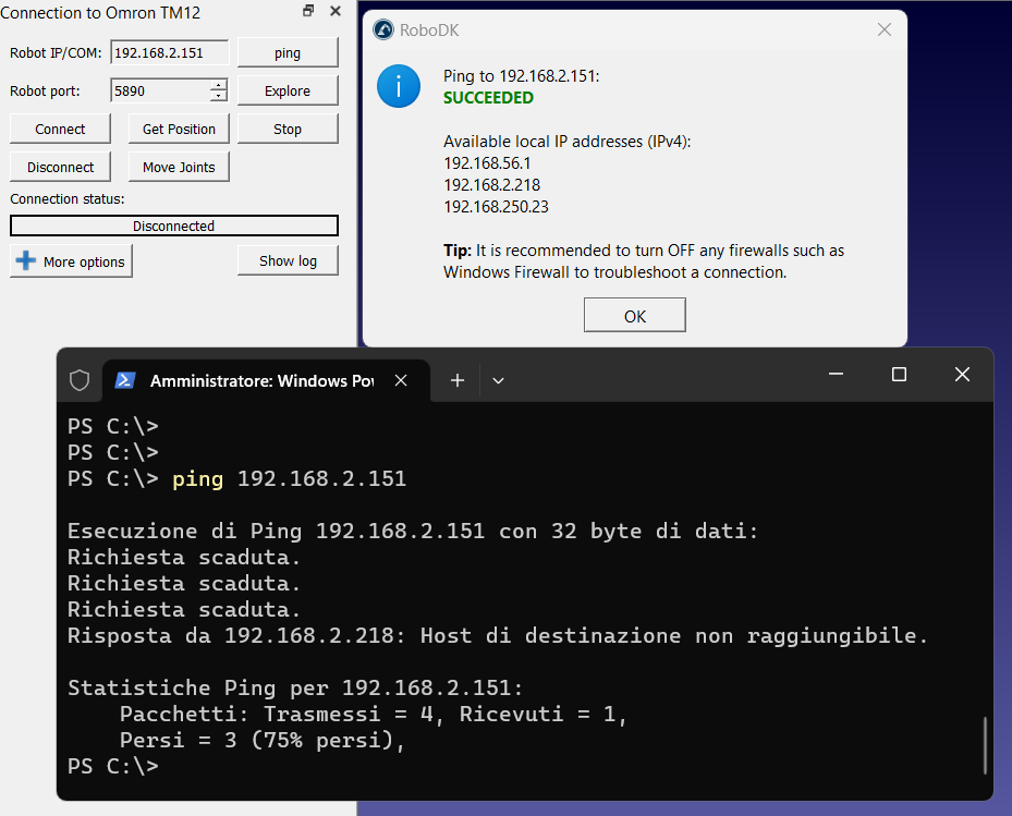

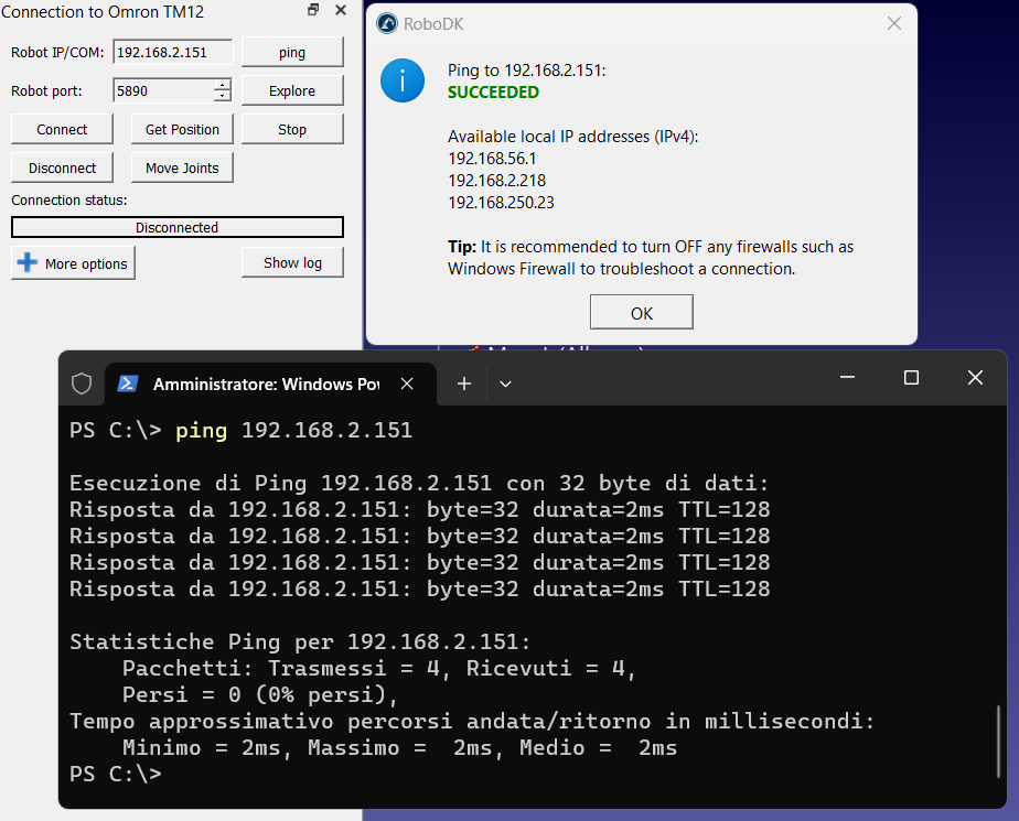

PS: found also a strange (wrong) behaviour when I ping the robot from RoboDK;
     Often I get Success even with ethernet cable disconnected from TM12...
    Of course from terminal the ping Fail as expected.

Regarding the ping issue: Are you using Windows? Can you send us a print screen of the result of the ping through the terminal and what you get through RoboDK?

RDK project and screenshot, from windows, in attach.
Regards
