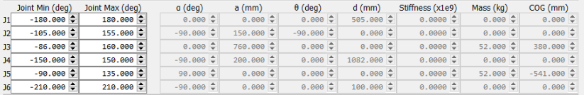

The software reports the robot parameters like attached image.
I believe it is assumed that the center of gravity of each link is on/along its x axis ( c = [COG ; 0 ; 0]), and mass of some links are negligible (Mass=0). Am I right?
