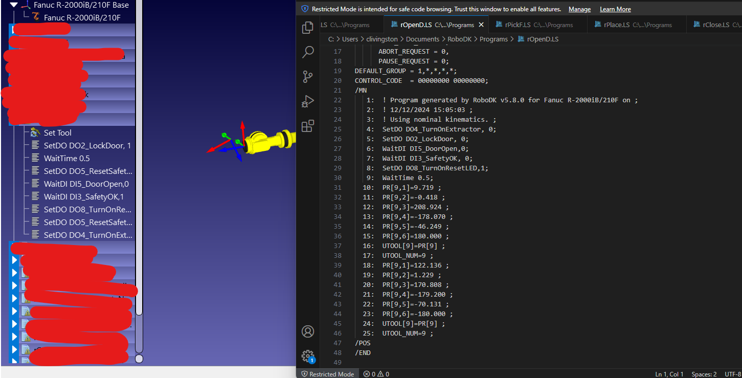

I have imported it and then converted it to a FANUC but I do not see any movements included. How do I make sure the movements and targets are moved over.
Another side note: It also gives me an error of importing code larger than 50 lines. Do I have to get a full license? Cost?
