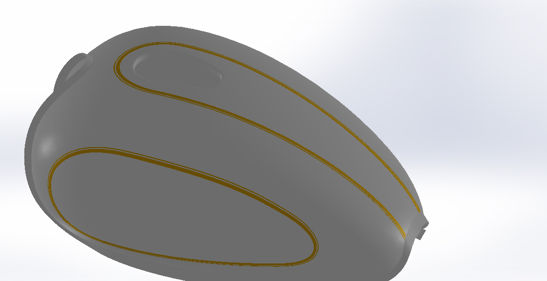

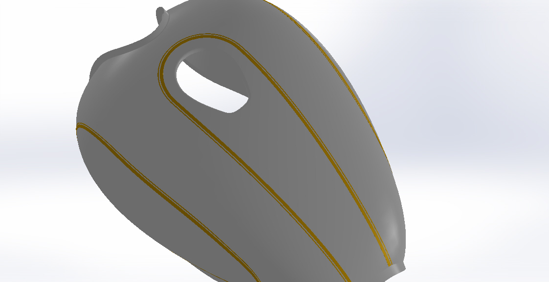

Currently i am working on a project for painting application where robot paints a profile along a curved path using a paint brush. i need the robot to orient its tool perpendicular to the path rather than just following it , i am attaching screenshot of how the final product should look like.
To have the tool perpendicular to the surface, select the curve and the surface when importing the curve to RoboDK.
