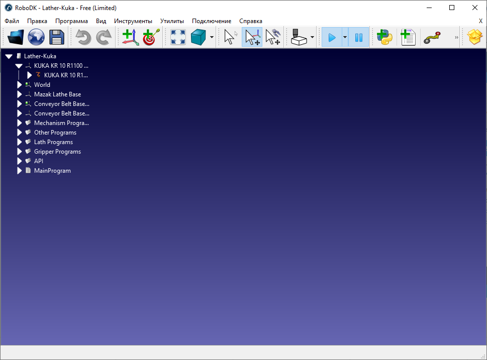

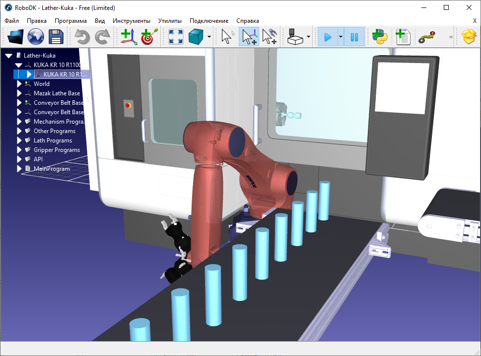

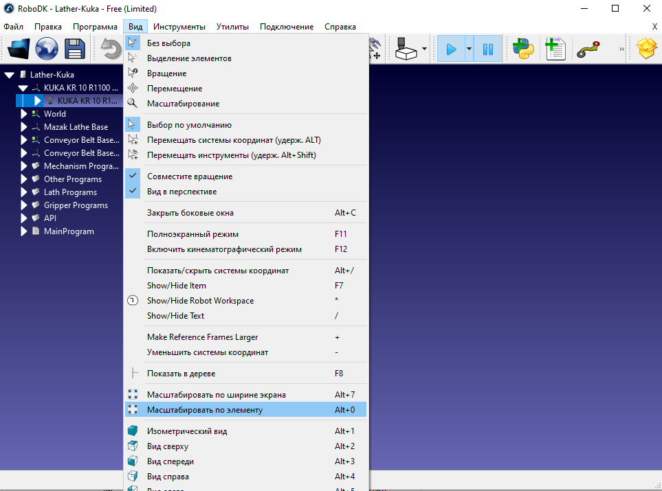

When you save the project, and then when you open the objects disappear, you can restore only through the menu View-Scale by element

This is because the frames associated with the conveyors are very far from the main station. You can set the frame on the conveyors to invisible to help scope the "Fit All".
