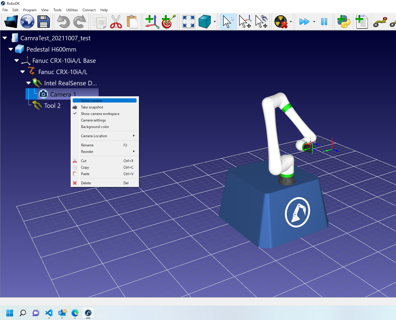

My OS is Windows 11.
I have upgraded v5.25 to v5.3.
In v5.25, when click 'Show camera' on the set camera  after App drop down.
When I contacted the dealer, it seems that it worked fine on Windows 10.

v5.2.5 works fine on Win11.
v5.3 on Win11
Select camera show menu.
App will drop.
Strange... Can you try placing the camera to the root of the station? (attached to the station item)
You can still link the camera to the TCP.
Do you still see a crash?
