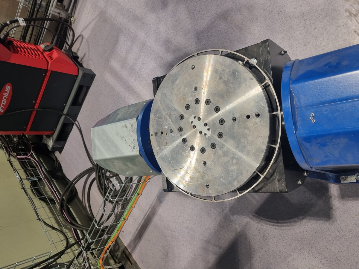

2: Mounting face plate is 45 degrees wrong. Angle of the 4 outer holes on the front(top) face is from stock setup 0 90 degrees and not 45 45 degrees. photos will follow. This can be changed in 'Robot/home position/absolute data' on the controller, but it is not the way stock yaskawa robots are set up.

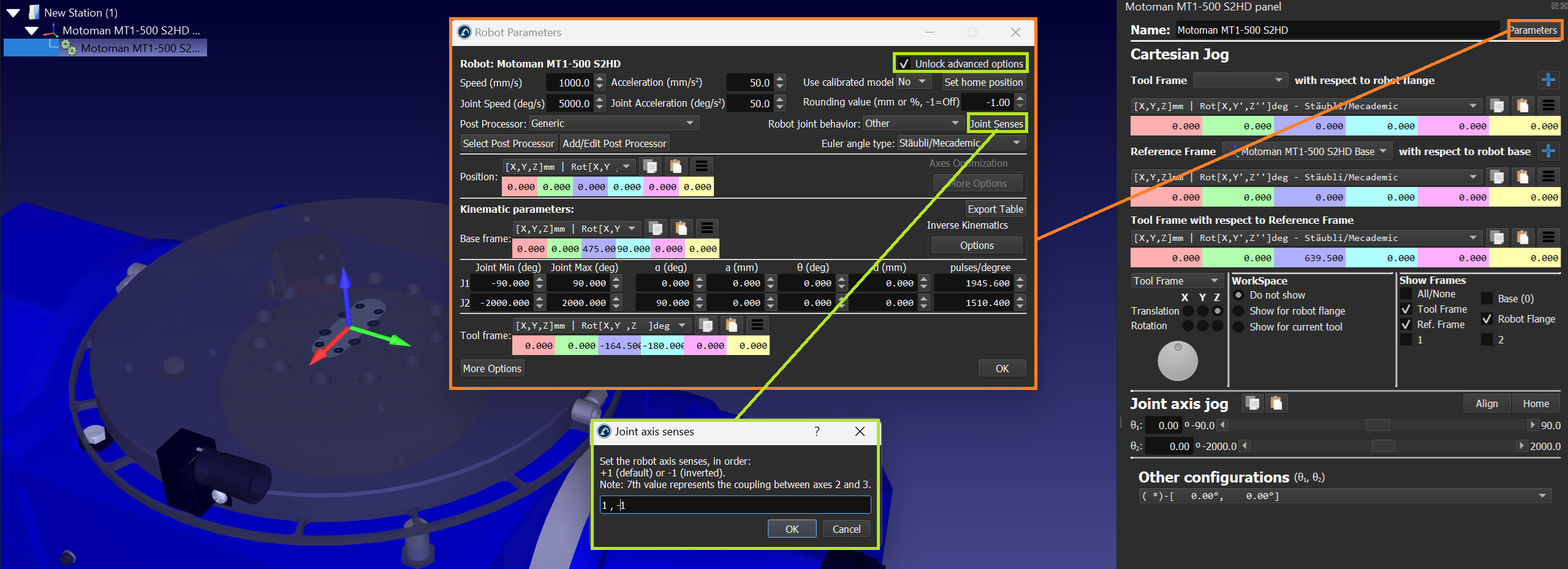

You can set the rotation direction on the Robot panel - Parameters - Unlock advanced options - Joint senses :

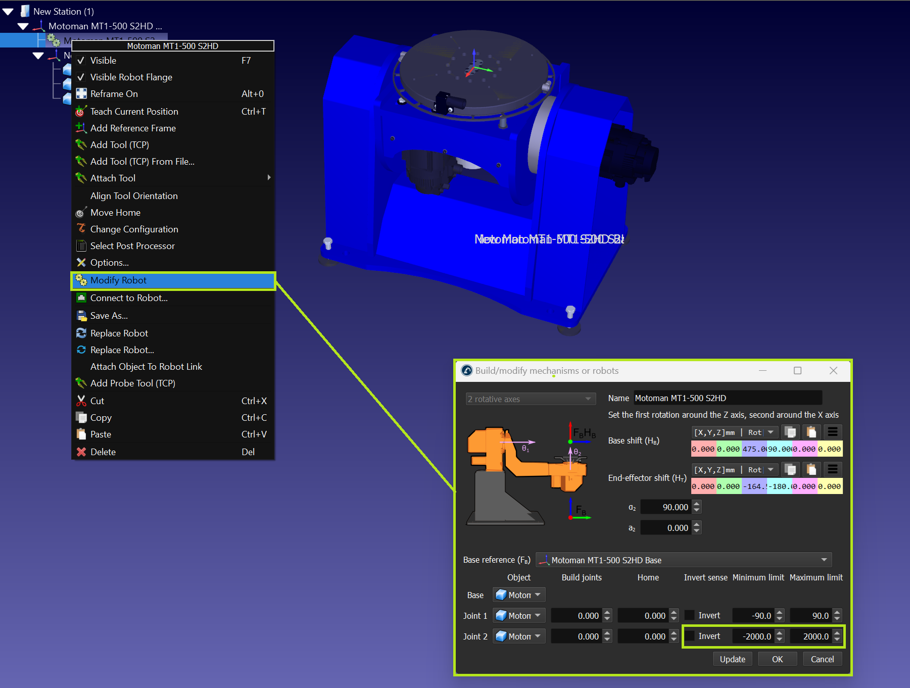

Alternatively, you can right-click on the robot - Modify robot - Invert axis :

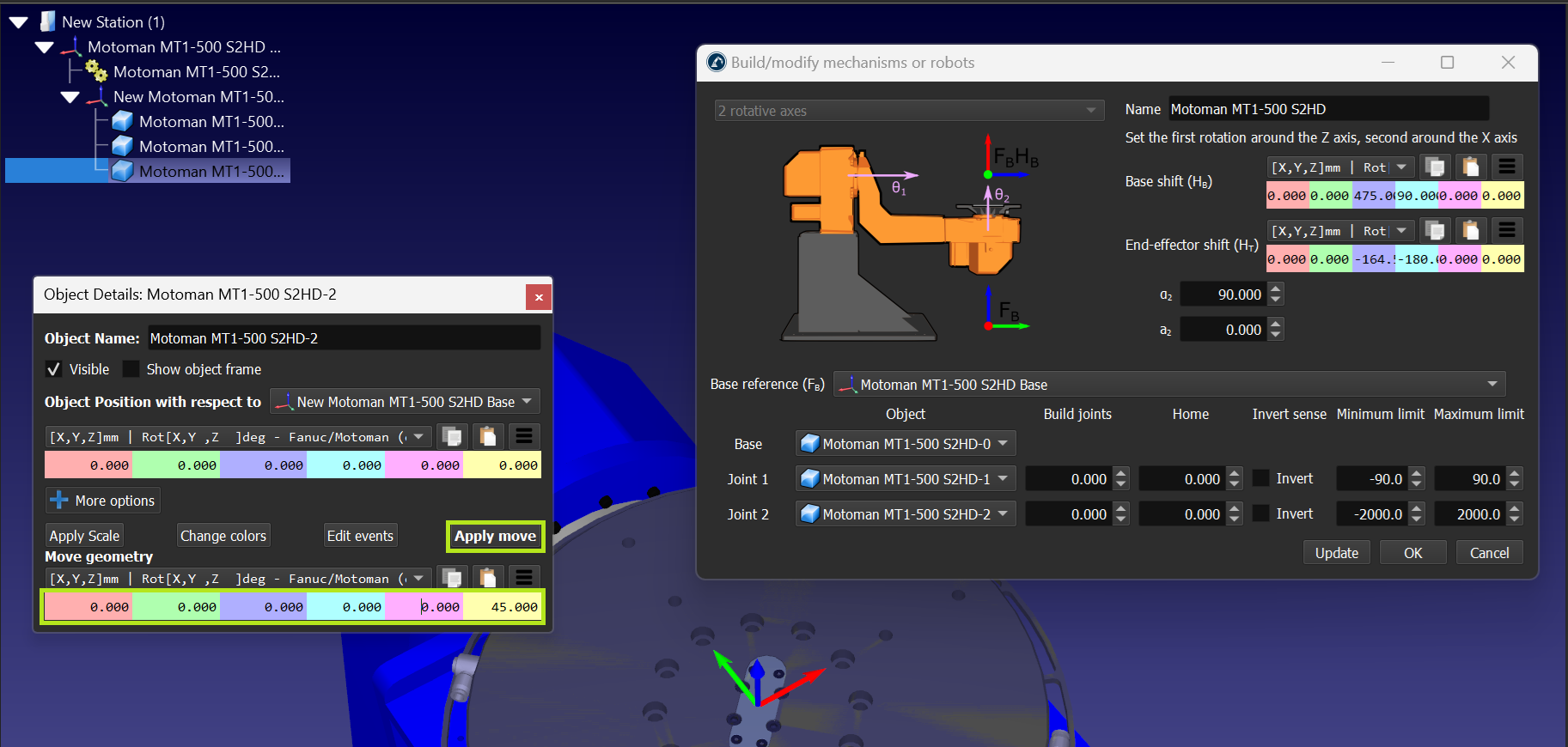

Also, you can adjust the flange model position:
I attached the corrected Motoman MT1 500 S2HD model.
