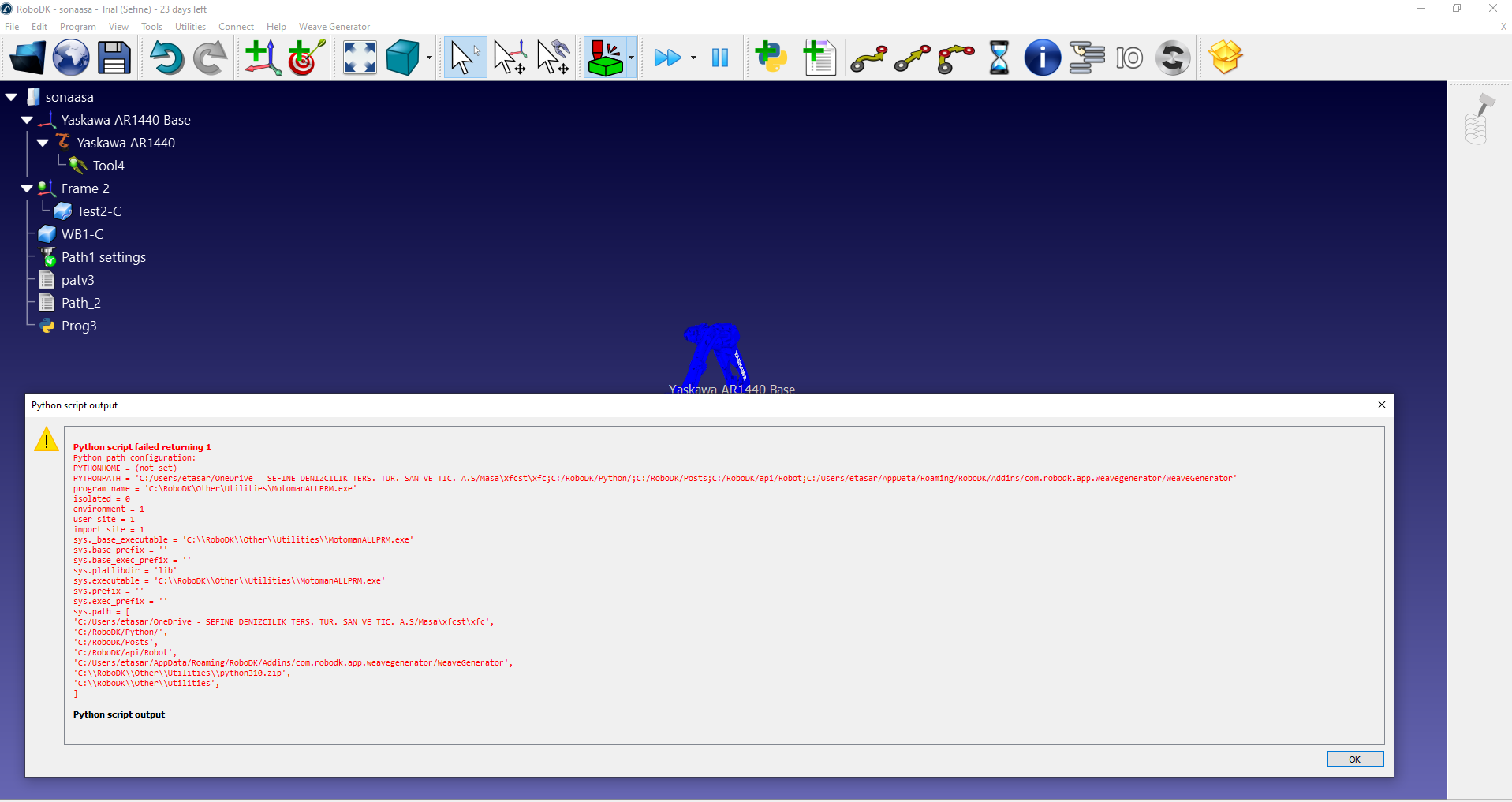

We are working with Yaskawa Ar1440 robot. Since I encountered an error when I wanted to transfer the codes we extracted from Robodk to the robot, I wanted to add the all.prm file I received from the robot to robodk, but I encountered an error.
I would appreciate if you can help me with this issue, what should I do?

I updated valuses for the robot in your station and the robot itself (attached)
.robot   Yaskawa-AR1440.robot (Size: 1.12 MB / Downloads: 359)
.rdk   sonaasa_md.rdk (Size: 1.83 MB / Downloads: 412)
https://robodk.com/download
