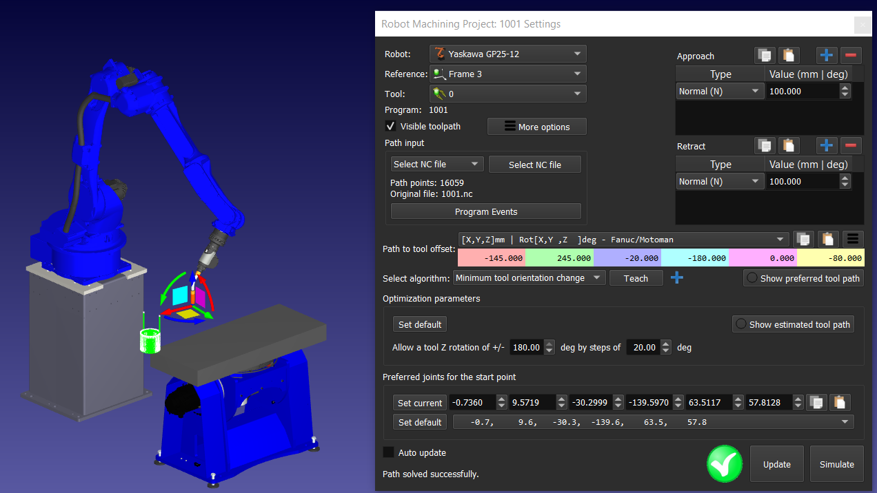

The robot model has a flipped arm in regards to the actual robot.
If I post with rconf 0.0.0.0.0.0.0 the model is nonflipped. The actual robot flips.
And the reverse if opposite.
In the picture the model is flipped. The actual robot is no-flip

The animation is opposite of model.
When it prints no-flip 1,0,0,0,0,0 with prefered joints, the model is FLIPPED. The actual robot is NOT.
Prefered joints print flip 0,0,0,0,0,0. Model is not flipped and the actual robot flips.

So I understand that our post processor for Yaskawa Motoman robots has the first bit of the configuration flags swapped?
When we output 1 it should be 0 and vice versa. Can you confirm?
(04-06-2024, 05:02 PM)Albert Wrote: So I understand that our post processor for Yaskawa Motoman robots has the first bit of the configuration flags swapped?
yes, can confirm!
