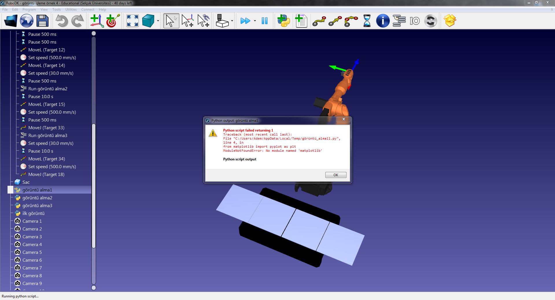

I work on image processing on the RoboDK.
I am getting an error while running the code, how can I solve it?
.rdk   görüntü işleme örnek 4.rdk (Size: 180.81 KB / Downloads: 796)
This means your RoboDK Python path does not have matplotlib installed.
You can do a pip installation with the help of the import_install method in the robolink submodule
https://robodk.com/doc/en/PythonAPI/robo...rt_install
it was very helpful. Thank you
