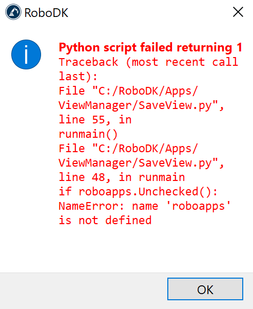

when I tried to use the view manager and save a view,
it gives the attaching image error message.
I use version 4.4. i opened "saveview.py" file. The line that wrote the following text
  from robodk import robolink, robomath, roboapps
and i change this line to:
from robolink import * # RoboDK API
from robodk import * # Robot toolbox
but My problem was not solved. please guide me.
What version of RoboDK are you using?
To use add-ins from the online library, you need at least RoboDK 5.5.5.
thanks. i use RoboDK v4.4. So unfortunately I can't define a view, Is there no other way?
You can purchase maintenance to update RoboDK to the latest version.
The source code of the ViewManager is also available here: https://github.com/RoboDK/Plug-In-Interf...iewManager
