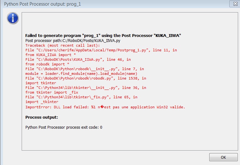

I'm trying to generate java code for iiwa lbr 820 for an short apt file presented bellow. robotdk post pro generates an error message (see bellow).
Any suggestions?
thanks
