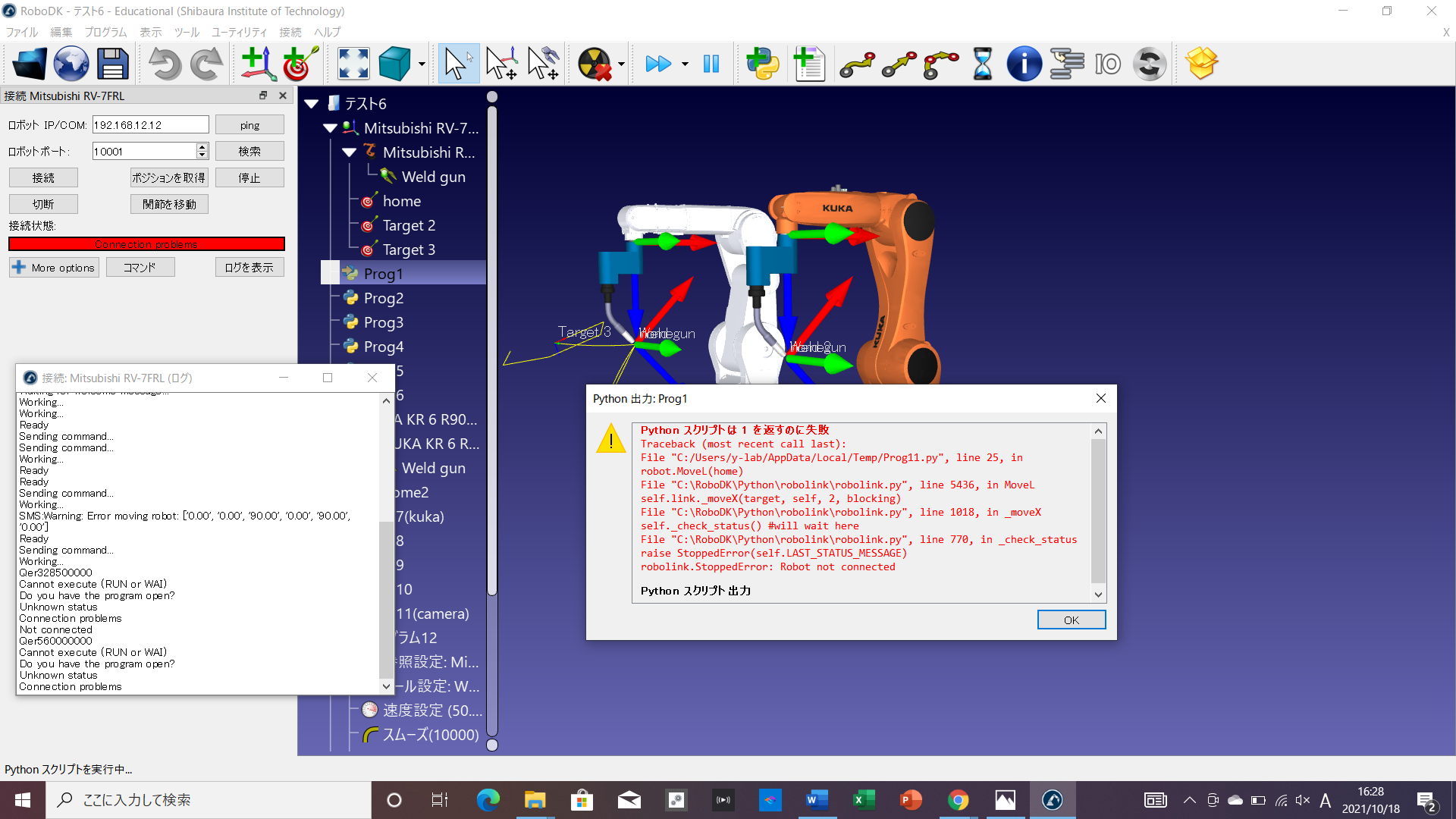

When I tyr to execute "MoveL", the robot stops moving with an error like the one in the second photo.
3. MoveC
When I tyr cxecute "MoveC", It stops at the "sending command" like the 3rd photo, or get an error like the second photo.

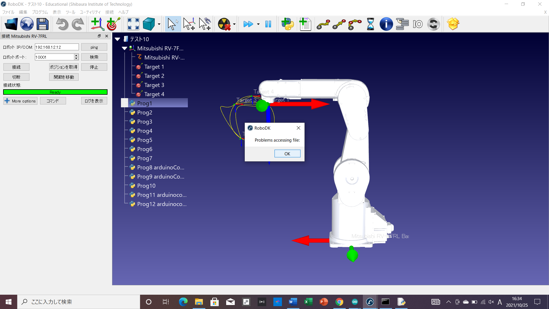

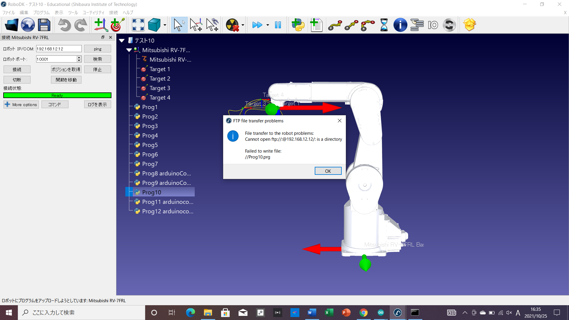

2. I can't upload the program to the robot
When I tried to upload a program to the robot to make it run smoothly, I coudn't. When I try to upload Prog1 of the attached program (test10) , I get error like the 1st to 3rd photos, and when I try to upload Prog10, I get error like the 4th to 5th photos.
Can these issues be resolved with the current version? if possible, please teach me how to do it.
