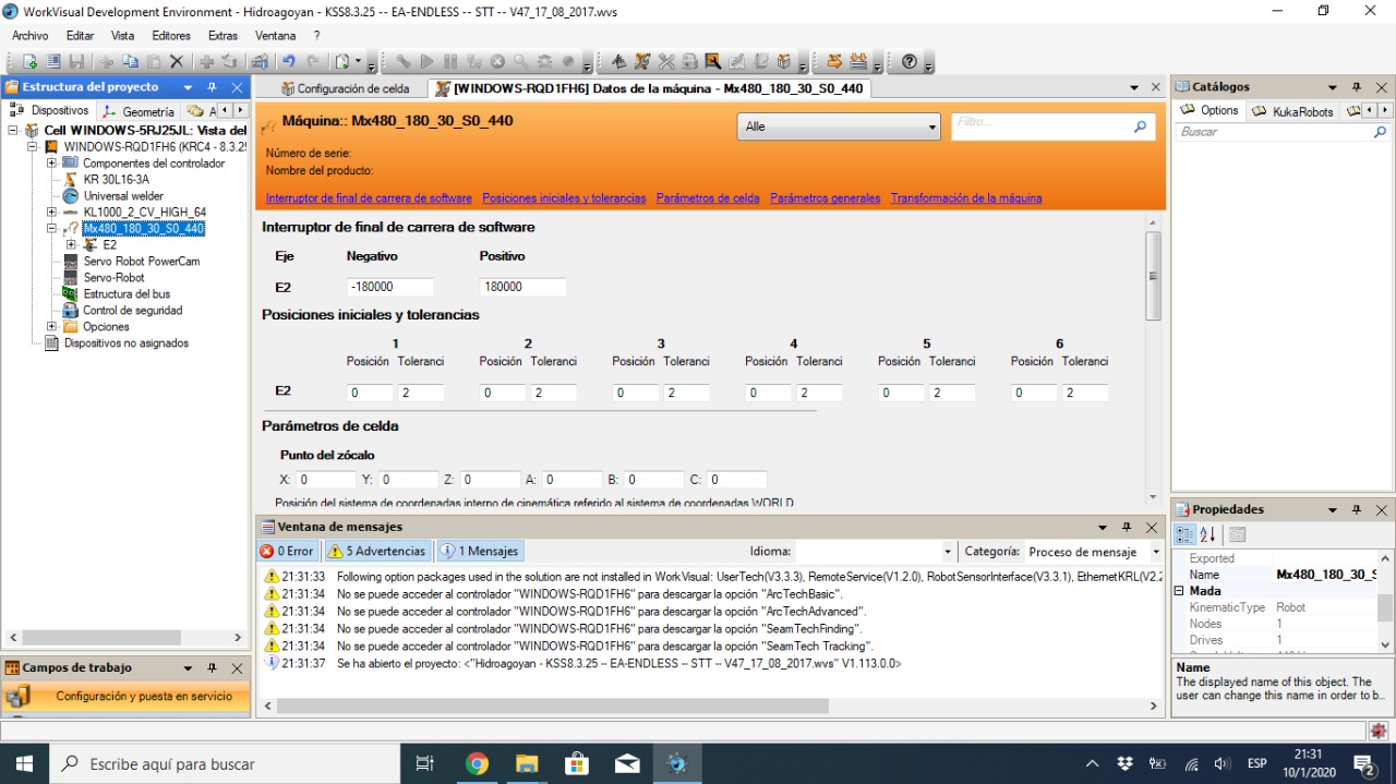

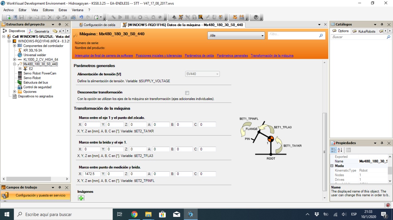

		Hello, I want to configure the parameters of the turntable that I attach in the workvisual screenshots, how can I enter them?

		01-12-2020, 11:49 PM
		The following instructions will help you model your turntable or other external axes:
https://robodk.com/doc/en/General.html#ModelRobot The information you show is the position of the turntable with respect to the robot. You can enter this position by double clicking the coordinate system of the tuntable and entering new coordinates.  |
