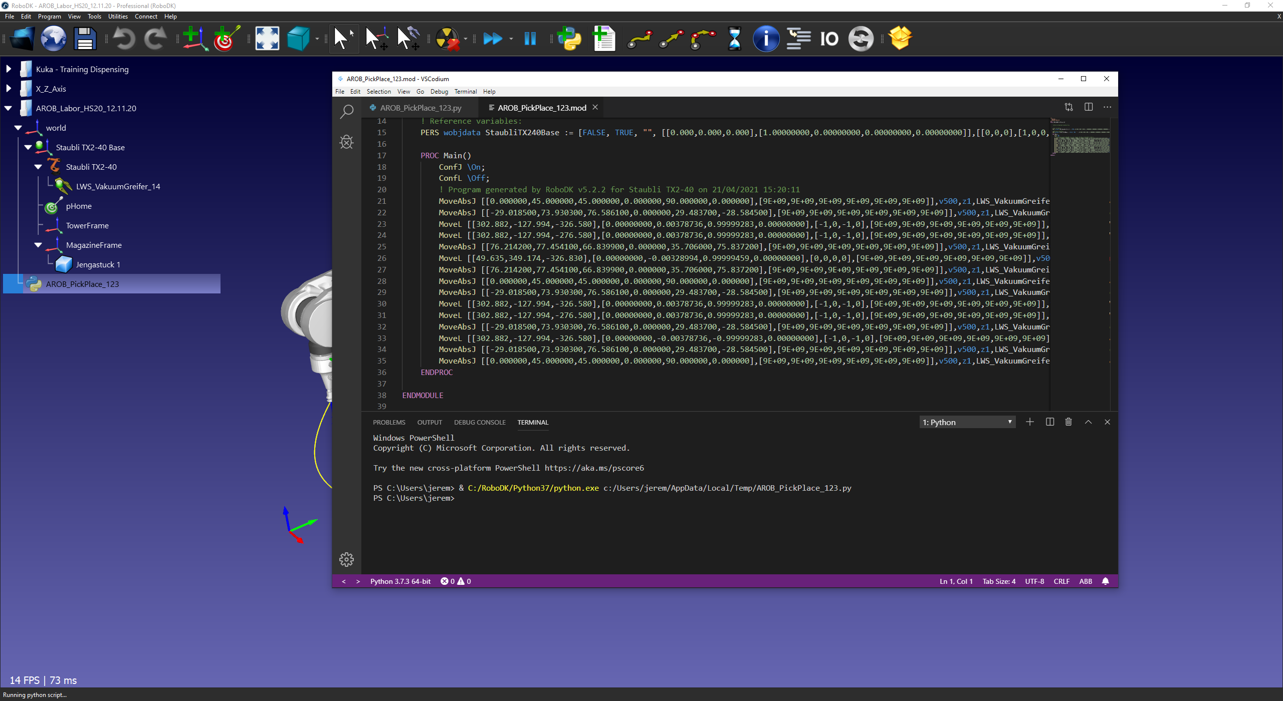

Hi Janis,
Could you try updating RoboDK to the latest version? Because I just tried it and it seems to be working just fine.
