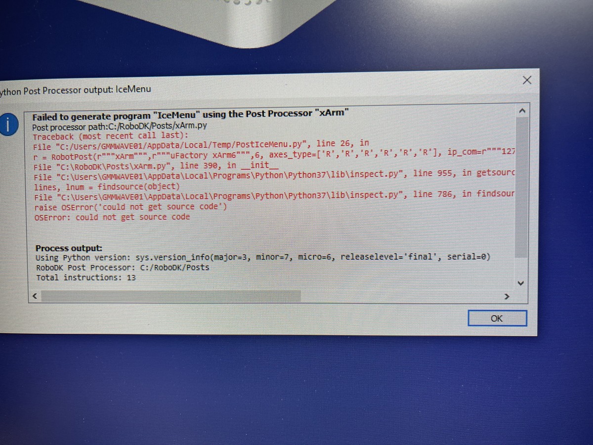

  • Dear everyone could you please help, I try to generate the software but this error occurs.
Hi, I had the same problem and solved it replacing the post processor xArm in C:/RoboDK/Posts/ with the file attached by Albert in this thread (xArm.py).
Just add this "import inspect" at the top of the xArm.py
There are a bunch of other errors you will run into depending on the robot model you're using but I'm currently working on fixing the post processor. Let me know if you have more questions. I will post the finished post processor file when I'm done with it.
