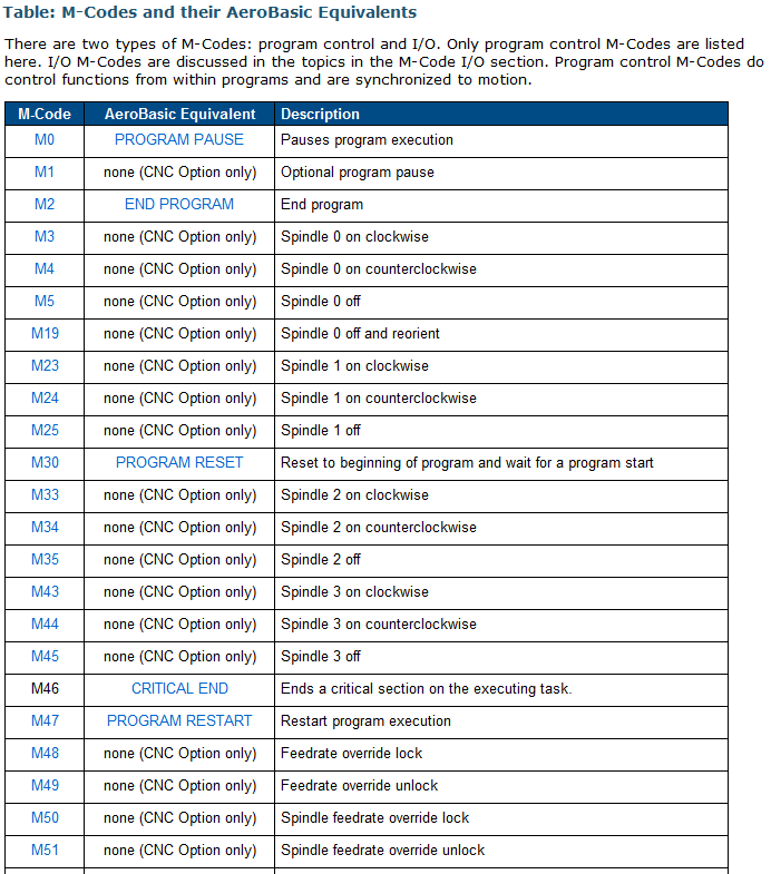

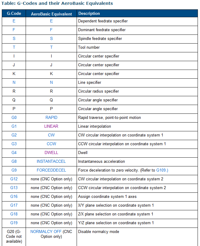

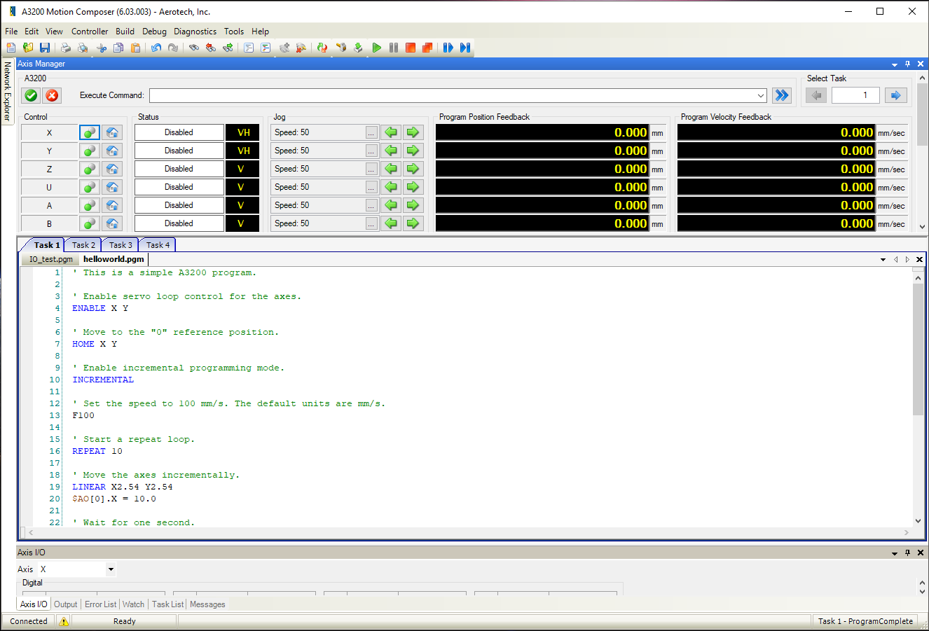

Hi Jeremy,
Thank you for your quick reply. Here is a screenshot of some code example from the documentation. I have also found equivalence tables in the Aerotech documentation (see attached images). So it would not be too hard to modify an existing post processor for this, indeed.
Do you know if there is one that is close enough? Any robot that you think its language looks the same or would be a good starting point?
Thanks,
JF
