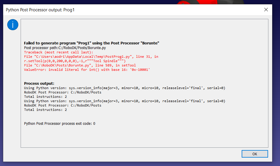

Hello Albert, I am trying to generate the program for Borunte robot but it doesn´t work, I attach the station and the error message. It is a simple program with two targets, Borunte 2110A robot and the library spindle. Thank you!
.rdk   Borunte test.rdk (Size: 1.35 MB / Downloads: 436)
#29
Please change the tool name to 'Tool 1'.
This is specific for the Borunte controller and it is necessary that the tools in the RoboDK station are numbered.
#30
I have changed the tool name to "1" (only number, no letters in it) and now it can generate the program, why can´t I write "tool_1"? thank you for your attention
