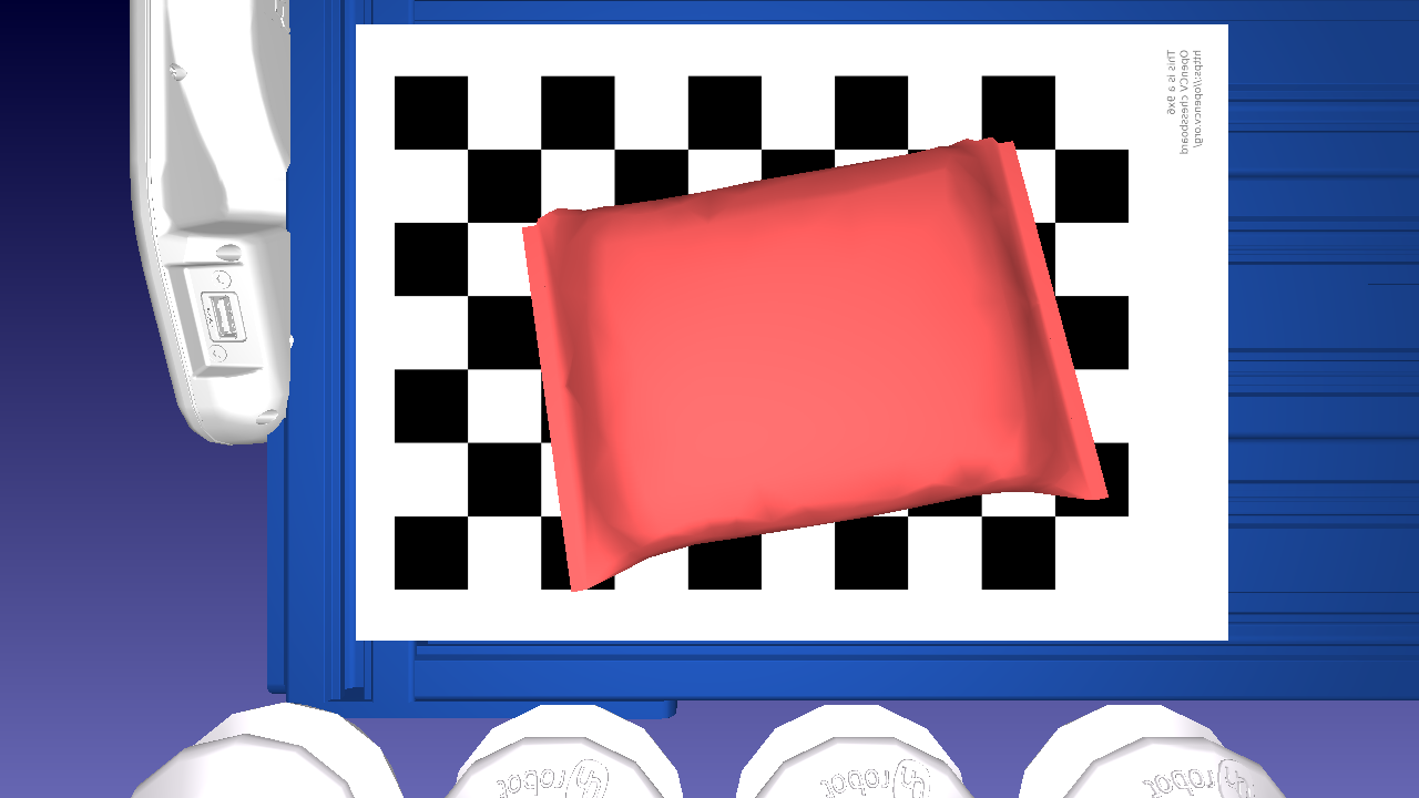

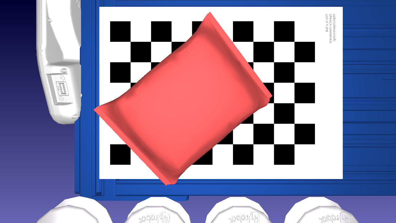

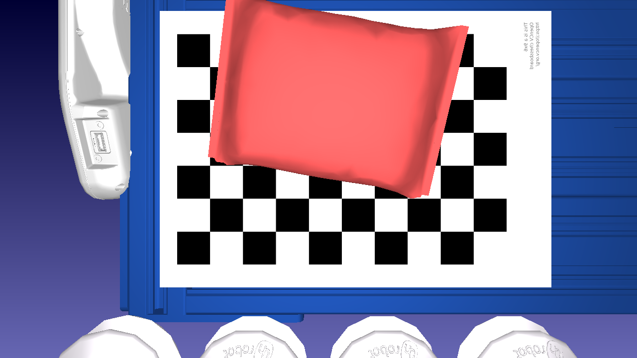

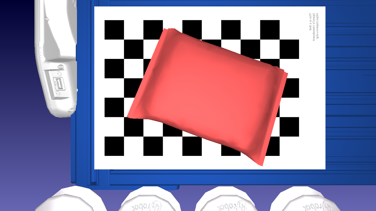

I did take about 10 pictures of the calibration board with the object (crisp packets) at different orientations on it.
Saved them to a folder and while running the code selected the right folder and then the error pops out.
Have attached the station and a few of the pictures I used for calibration.
I tried it without the object it does work. So the calibration is just to find the corners of the chess board?
Then I got where I went wrong, I thought it was to teach identify the object.
So should I take the chess board pictures with the robot arm (camera attached) in different orientation?

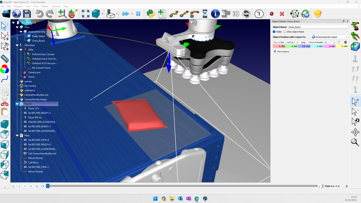

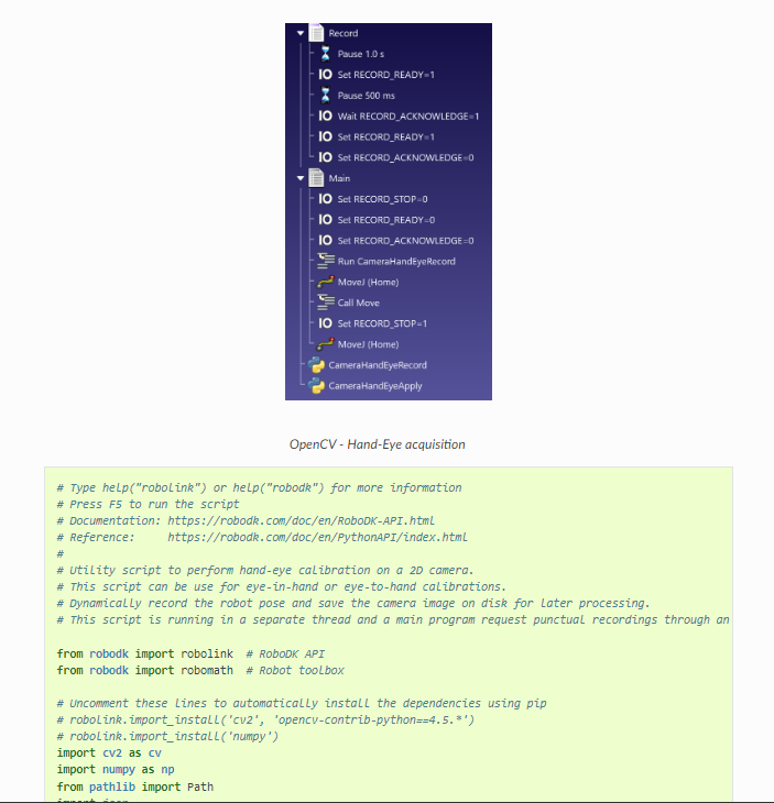

Tried executing the Main program and then the Record program but its stuck waiting for RECORD_ACKNOWLEDGE=1

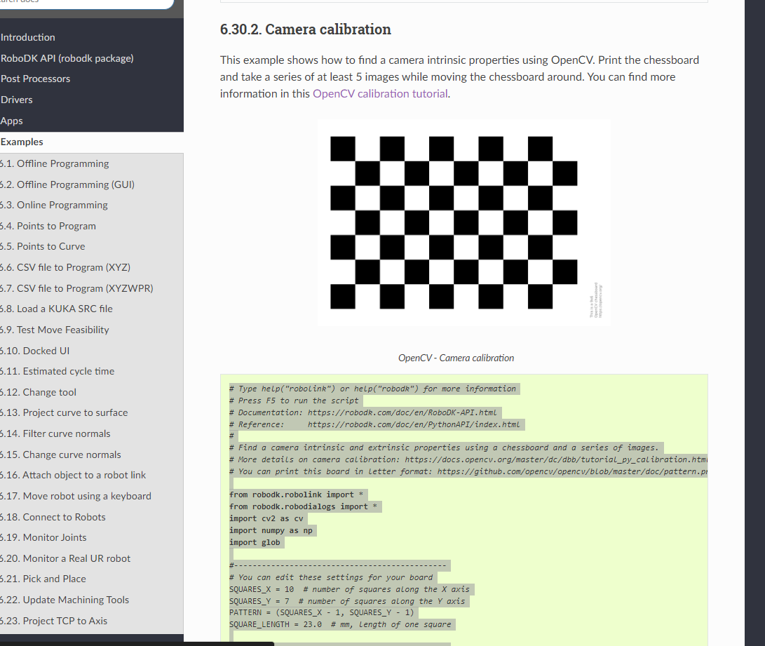

The calibration you pointed out is the calibration of the intrinsic camera parameters only. I recommend you to do the Hand-Eye calibration instead, this calibrates the intrinsic parameters of the camera and also the relationship between the robot flange and the camera eye pose.

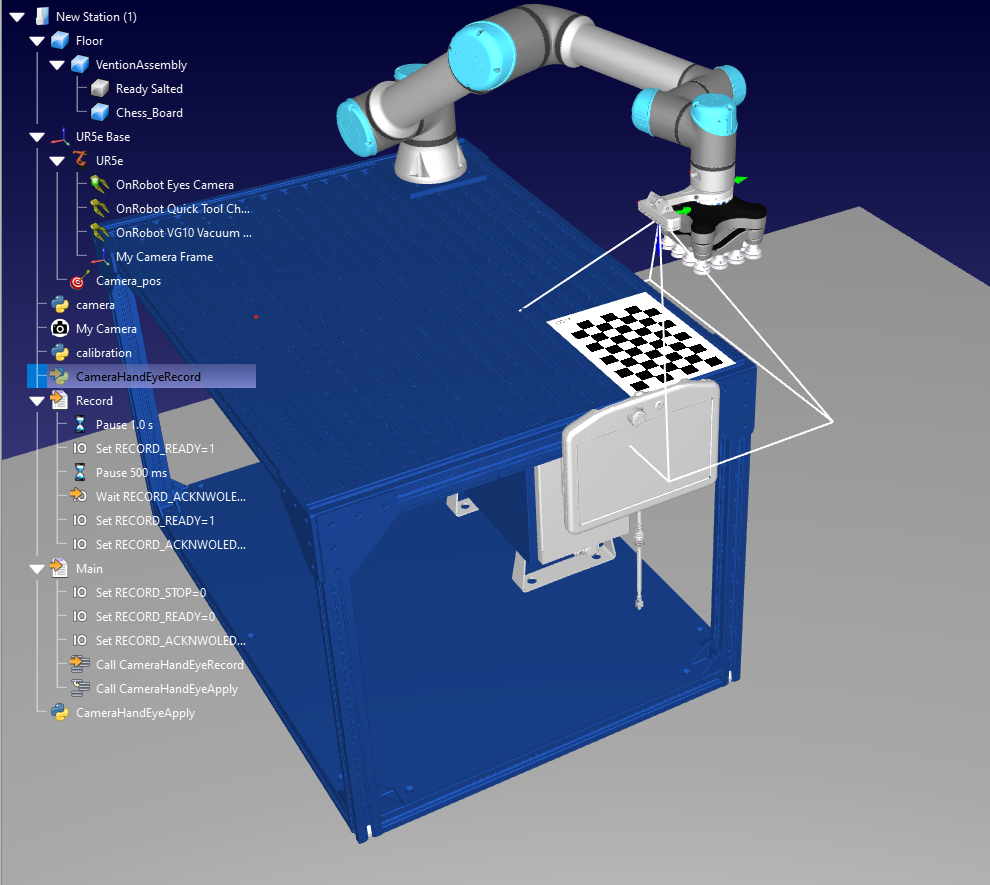

1) There is a 'call Move' in the Main program; What is that?
2) The main program gets stuck at 'CameraHandEyeRecord'. (picture attached)
3) Where should the 'CameraHandeyeApply' be used ?
4) Home position on the Main program, is it just a random point.

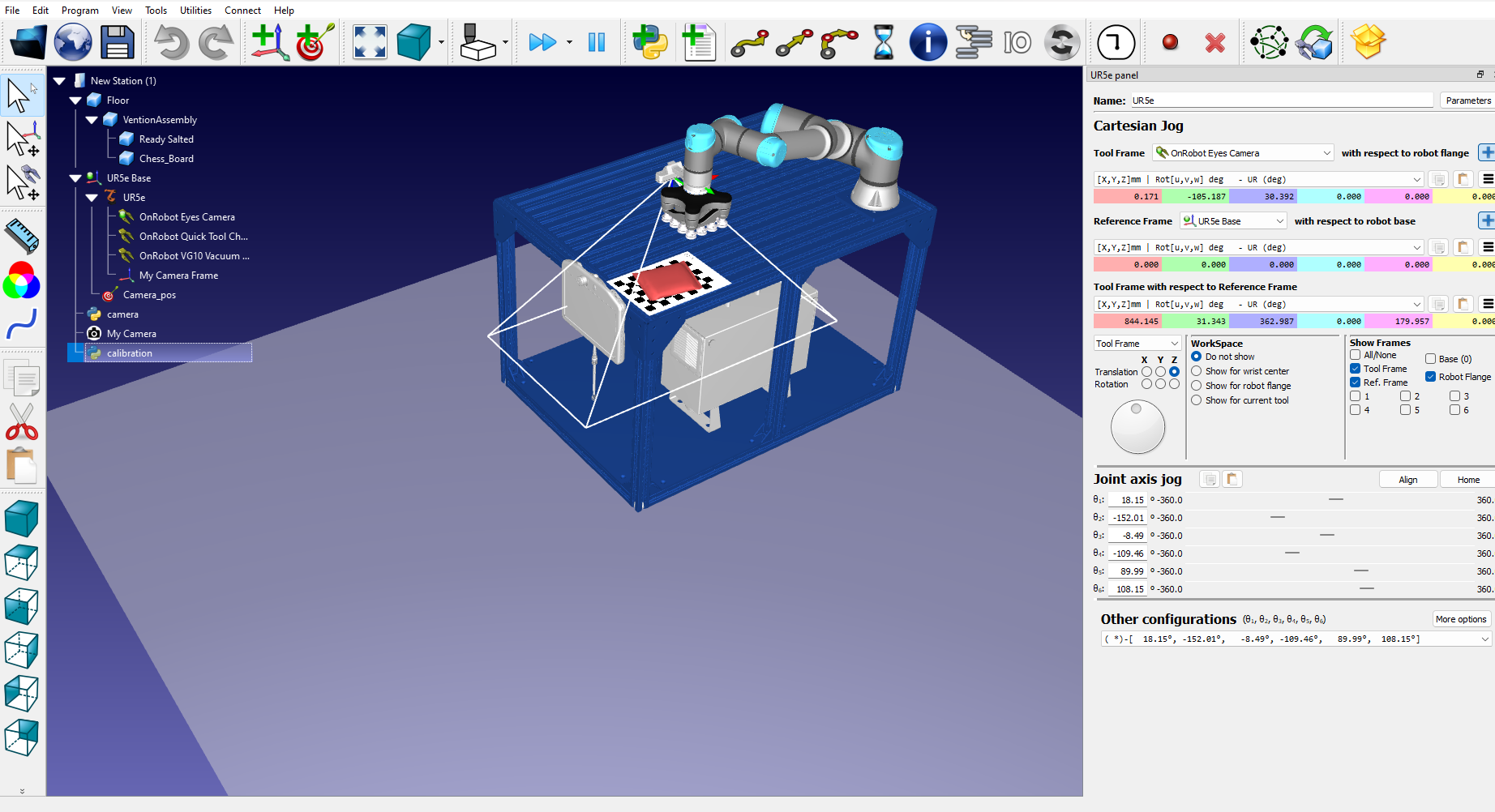

5) The Chess board becomes invisible each time I re-open the station. (can be seen in picture)
Tried executing main with the flange just above the object (Chesss board + crisp packet).

Hand-eye calibration is used to locate the real camera position with respect to the robot flange. This is done by detecting a fiducial marker (without any object covering it) at different robot locations. The procedure is unrelated to the detection of the object itself (like your crisp bags). We can also use these same images to define the intrinsic parameters of the 2D camera.
