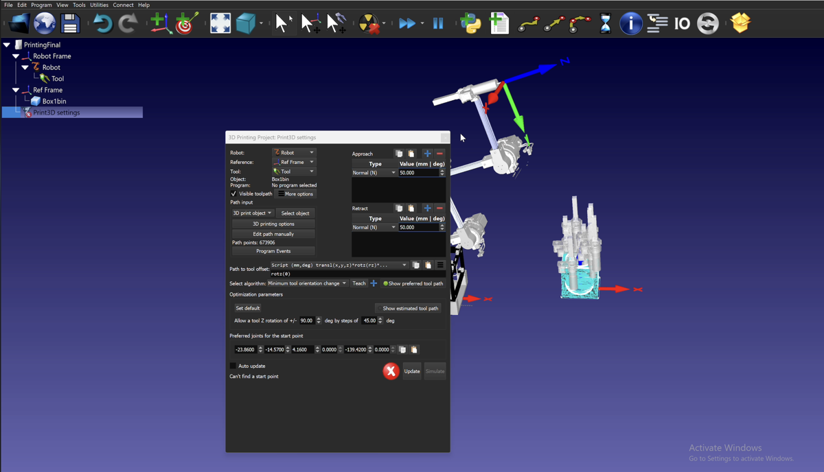

Can’t find starting point in 3D Printing
Not sure what's the problem here. I have the correct TCP orientation

I'm trying to print this stl box using my robot

It looks like you are trying to use a 4-axis robot arm. It will be challenging to accomplish this task. You should properly align the coordinate system and the tool to make your robot work like a 3-axis CNC.
I see, is there any tutorial on how to do so?
You can find some examples here:
https://robodk.com/doc/en/Example-3-Axis...ining.html
3D printing, curve follow projects and robot machining are handled very similarly with RoboDK when it comes to converting a path into a robot simulation and a robot program.
