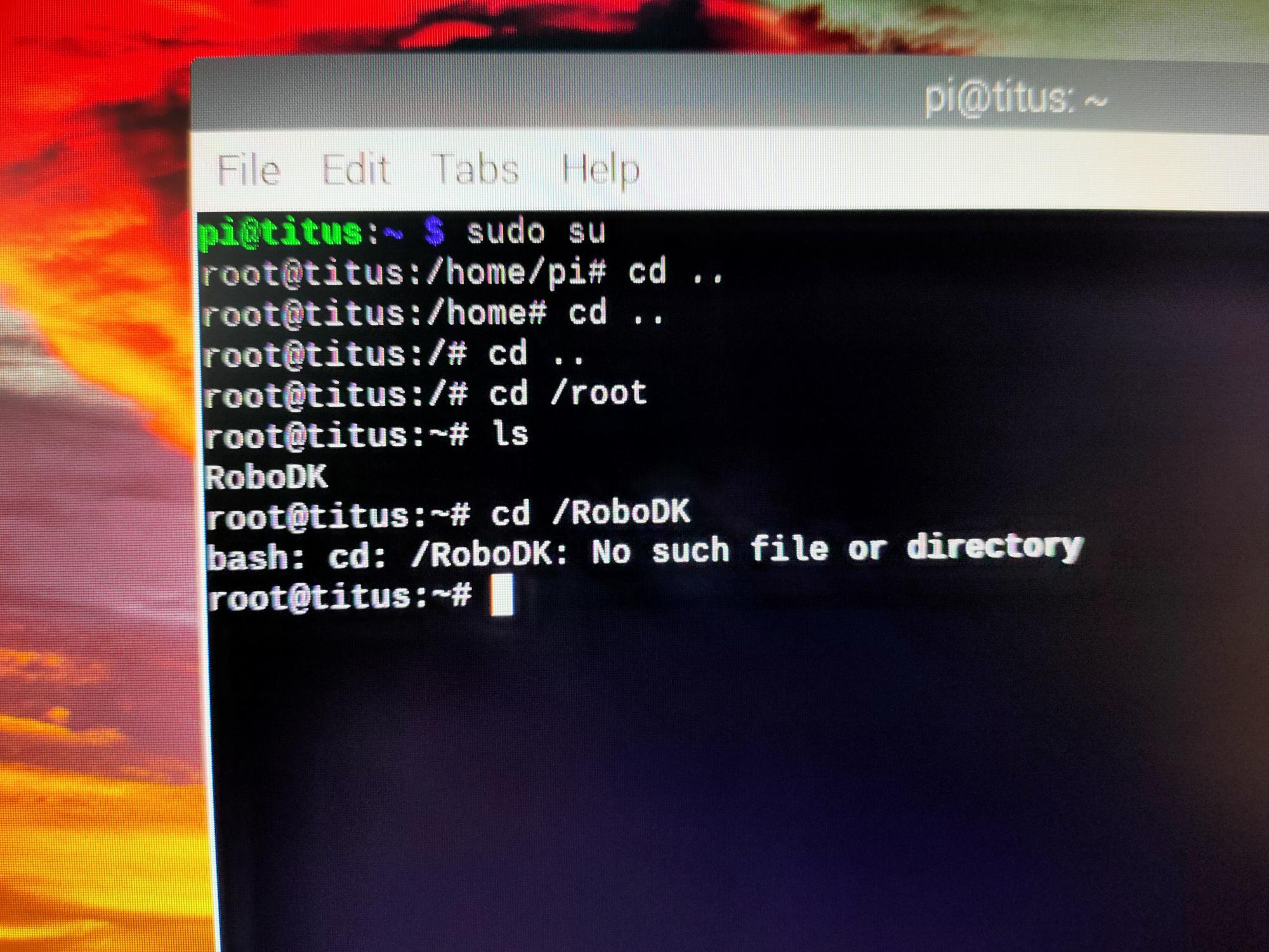

I'm having exactly the same issue as omkar11023, while attempting to install RoboDK on the Raspberry Pi.
It's installed 'successfully' in root and can be seen in there but at the same time it doesn't exist. Using sudo isn't helping either, unfortunately.
I really think a thorough instructional video would benefit a great number of people and enable them to get use and enjoyment out of this version of RoboDK. It would be greatly appreciated.

Here is my install script output:
pi@titus:~ $ sudo su
root@titus:/home/pi# cd Desktop/Install-RoboDK-Pi
root@titus:/home/pi/Desktop/Install-RoboDK-Pi# sudo ./Install-RoboDK.sh
